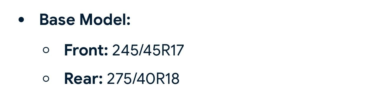

Rear tire diameter is to small compared to front tire. You should have went 285/40/18, or just stuck with stock size of 275/40/18. Whoever put the tires on should have told you this.

Your 255/40/17's are 25" tall.
Those 285/30/18's are 24.7" tall.
Another good option would be 285/35/18's @ 25.9" tall, on the rear.
