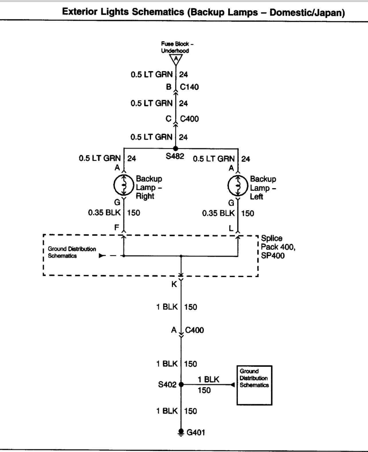

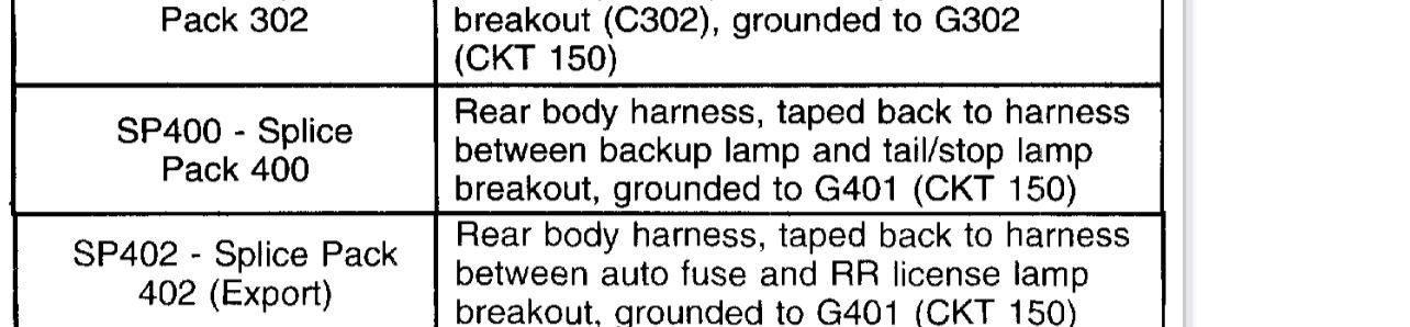

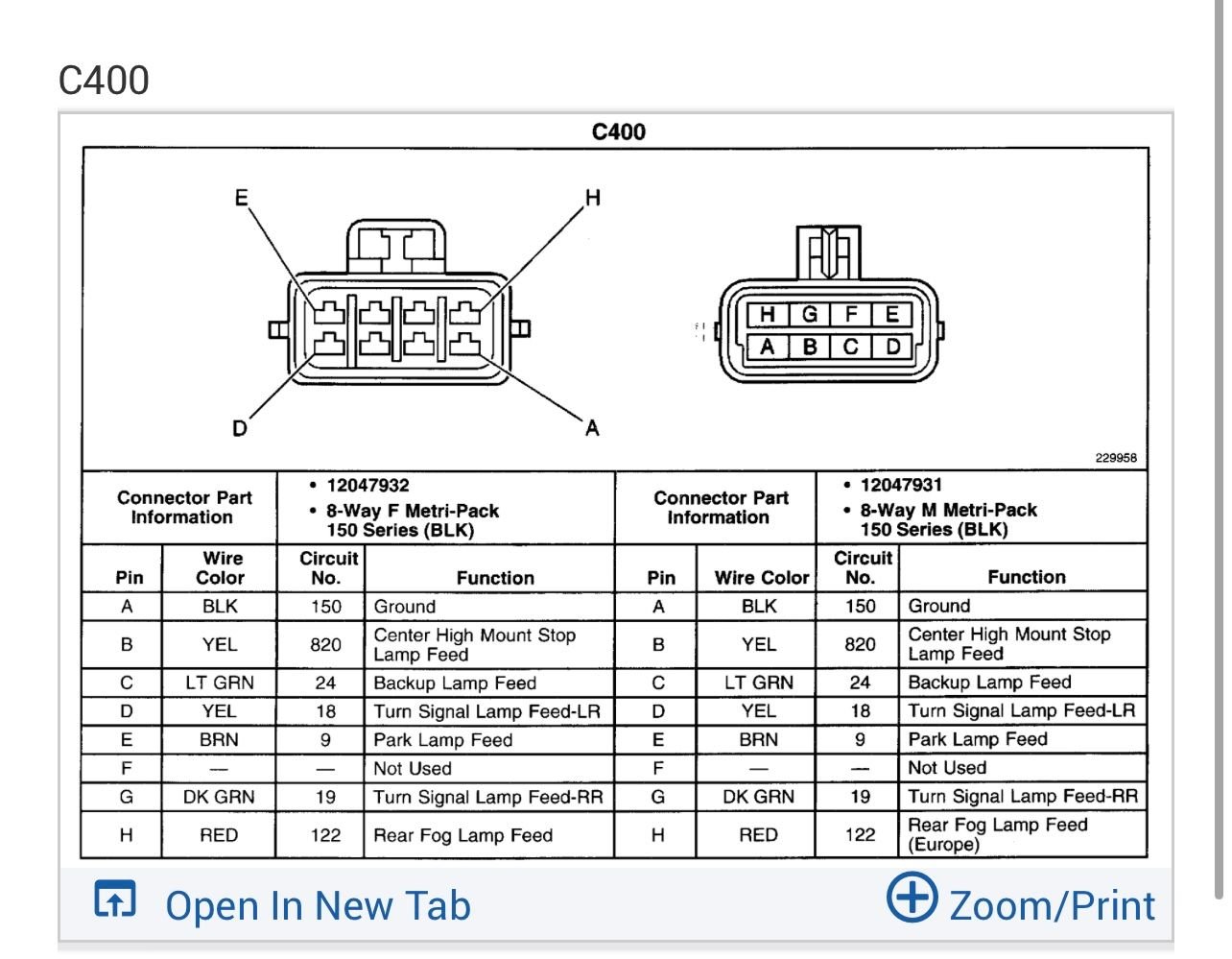

If you are unfamiliar with reading wiring diagrams you have Splice Pack 400 then to C400 (Connector 400) and Splice 402 (S402) then finally to G401 which is at the left rear frame rail which is also the ground for your fuel pump…remove the back up bulb and with a test light connected to battery POSITIVE probe the black wire on the bulb terminal…the test light should be bright if the ground is good…you can find a clean ground in the back and see how bright the bulb should be…use an incandescent 12 volt test light.
