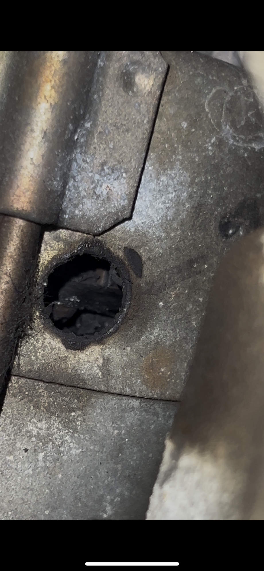

Today I got underneath the car to start the replacement of my starter. I could see on the bottom of the starter through a “peep hole” that the internal of the starter motor looks charred black. I am hoping the electrical smoke came from the starter motor and NOT any of the associated wiring as that will be a bigger PITA.
Will keep updated on what the outcome of the starter replacement is.

Default Peep Hole into starter motor
Charred black internals of starter motor through “peep hole”

Replaced the starter. This fixed the no start/no crank issue.
I suppose the P1518 code was somewhat irrelevant to the fact that the c5 would not start.
P1518 code is no longer current

Turns out, the P1518 code was most likely due to a low voltage battery due to me trying to start the car over and over after the starter burnt out. The P1518 code was somewhat irrelevant to the starter burning out. It’s been over a week with the new starter and no more issues to report related to a P1518 code.
