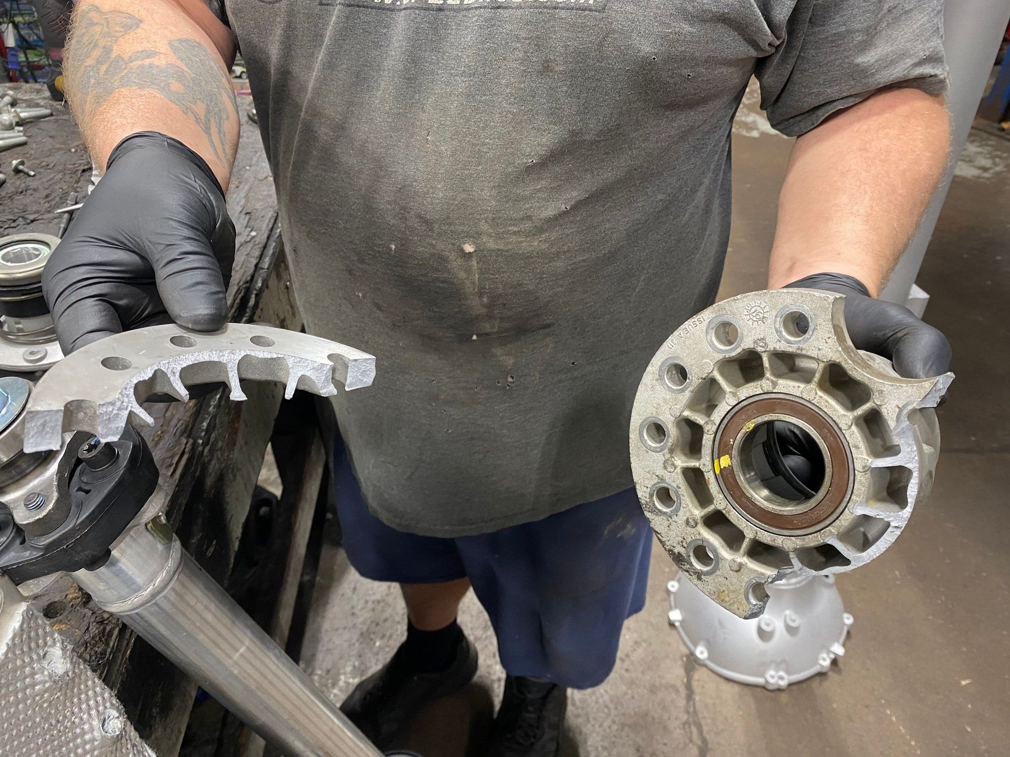

1998 coupe. 431 rwhp. Four launches and carnage. Fix was a newer 01-04 from RPM they had serviceable with new brgs and rubber couplers they had in stock. So far so good.

...and that probably represents one of the most infrequent failures in the C5 driveline. It's almost always the differential that gives up the ghost. I rebuilt my stock 99 torque tube when I did my supercharger in 2007. 500HP/530TQ....and lot's of very unforgiving hard launches at Byron on sticky drag radials. I did install an RPM differential at the same time though.

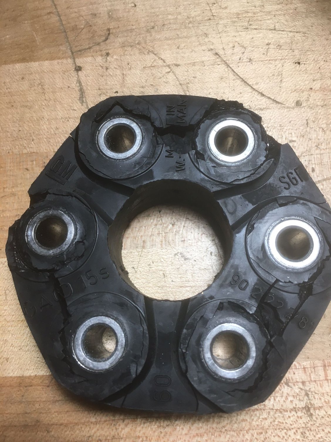

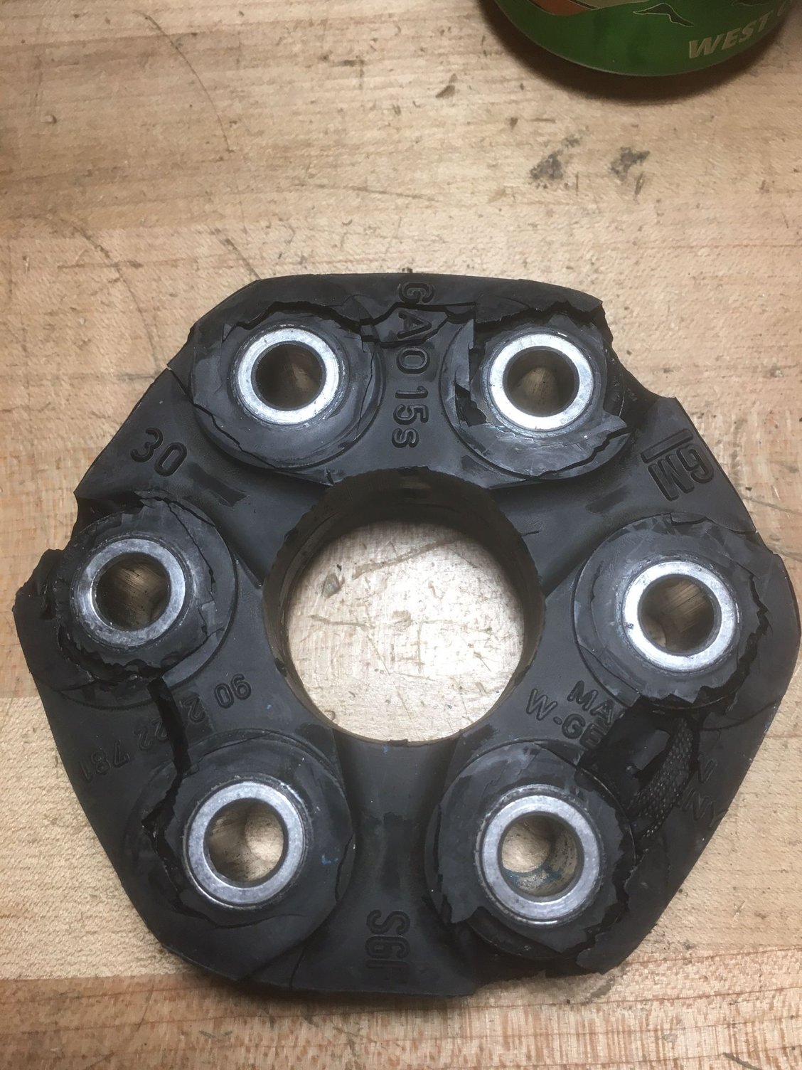

My 2001 A4 had 28 days on road course tracks, 10,000 WOT 2-3 upshifts and off throttle downshifts, 121,000 miles on these torque tube couplers when they were replaced. No symptoms were noticed but it was time.

My thought is that none of us know what the couplers look like unless they are removed for inspection. The Manual trans couplers are probably stronger and with 12 mm bolts instead of 10 mm. but take more shock loads than an A4 will generate.
The unsaid part of my above post is that after having the original torque tube rebuilt, an annoying vibration resulted 3,800 through 4,800 rpm so it got rebuilt twice more by different shops. Vibration was lessened but still there. All three shops insisted that the vibration was from the torque tube -- so the following is on order. No couplers. if it vibrates at least it will not break.
