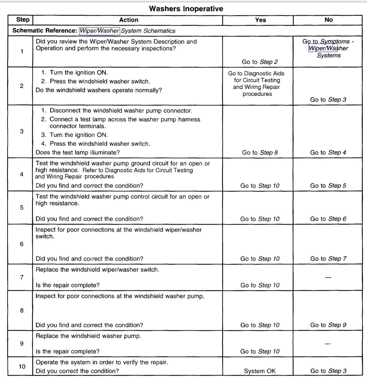

Hi All,
My C5 Corvette doesn't spray windshield washer fluid when pressing the button nor does it make any noise.
We've checked the fuses and the pump and they are in good condition.
Any ideas what it might be?

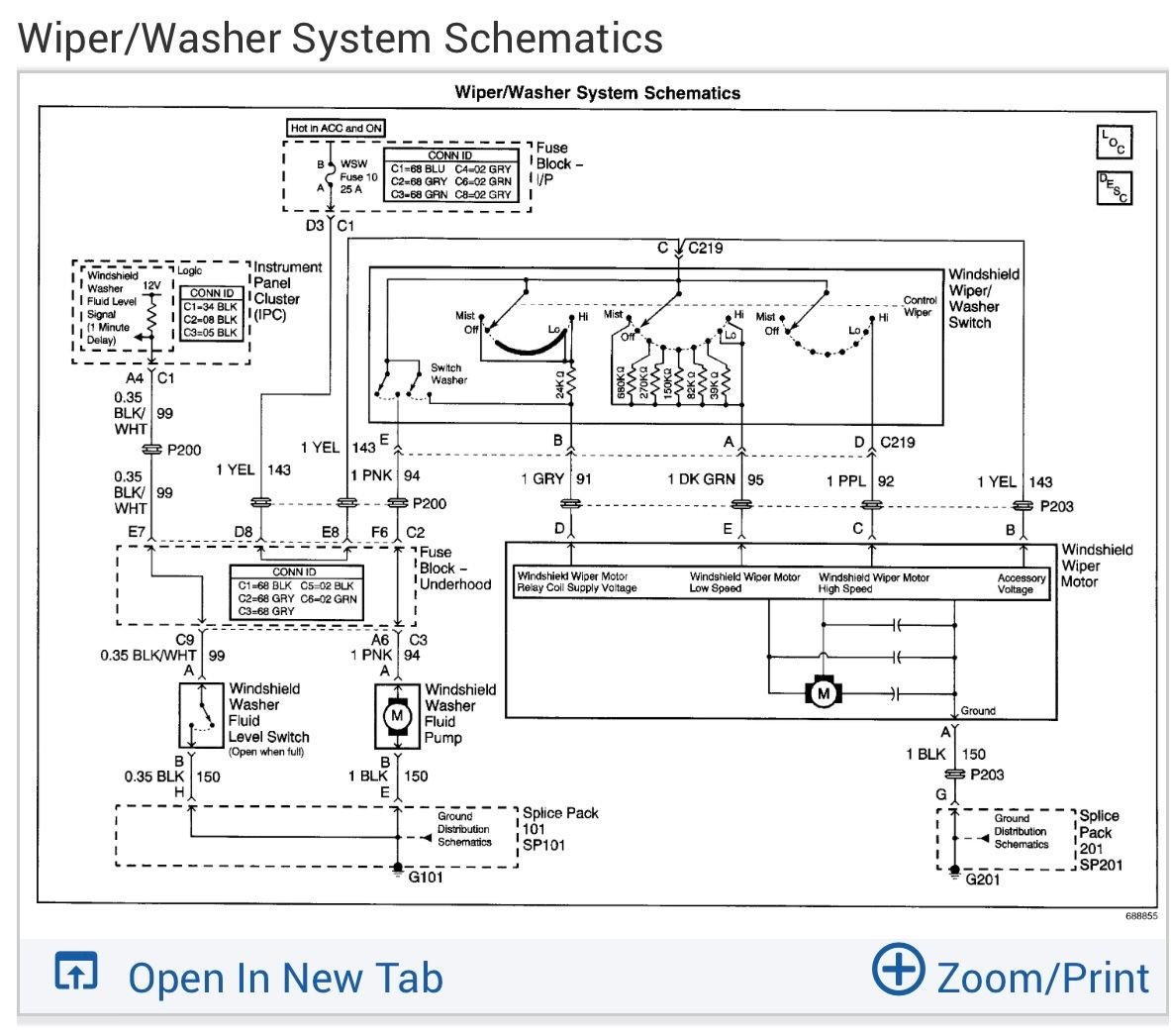

Also if any one has the wiring diagram for the windshield washer system that would be awesome.
Thanks.

As a minimum you should at least let us know what model year you have as wiring may change depending on the model year.

Thank you so much for the diagram and the steps.
Sorry for not mentioning; its a 2000's base model M/T.
Listed is a 2002…should work !!
