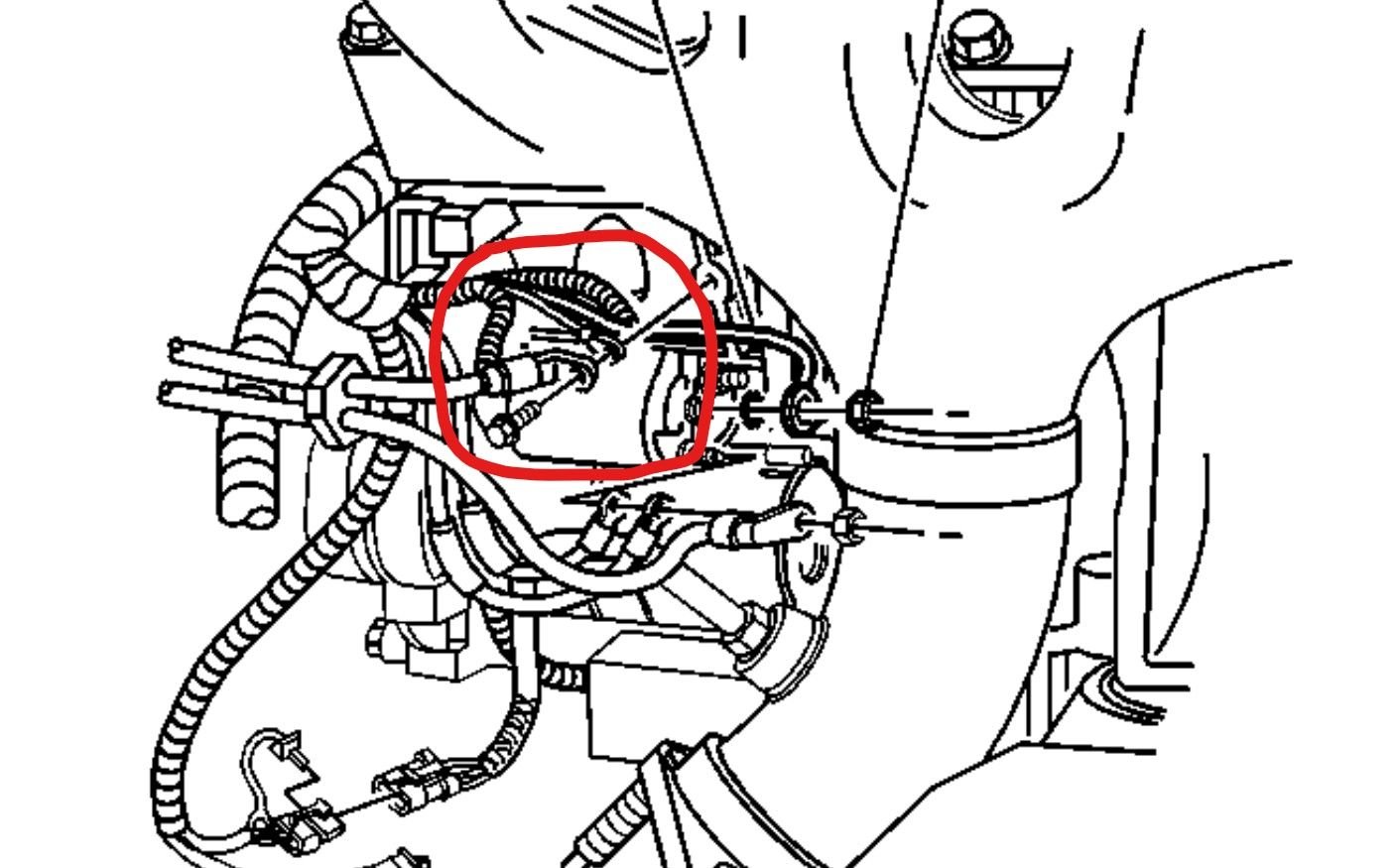

You should have two (2) fusible links at the starter solenoid. One is a 16 gage fusible link for the main car wiring , and the second is a 20 gage fusible link for the battery gage in the dash. You need to check each one a replace the one(s) that are bad

Positive battery voltage is wired from the battery to the engine fuse box, and there is a second cable at that same connection point that supplies 12v to the interior fuse box. The one fuseable link by the starter is the output wire from the alternator, it's purpose is to provide short circuit protection if the alternator shorts to ground.

While there are fusible links from the alternator to the starter, they have zero to do with power from the battery to underhood and IP electrical centers.

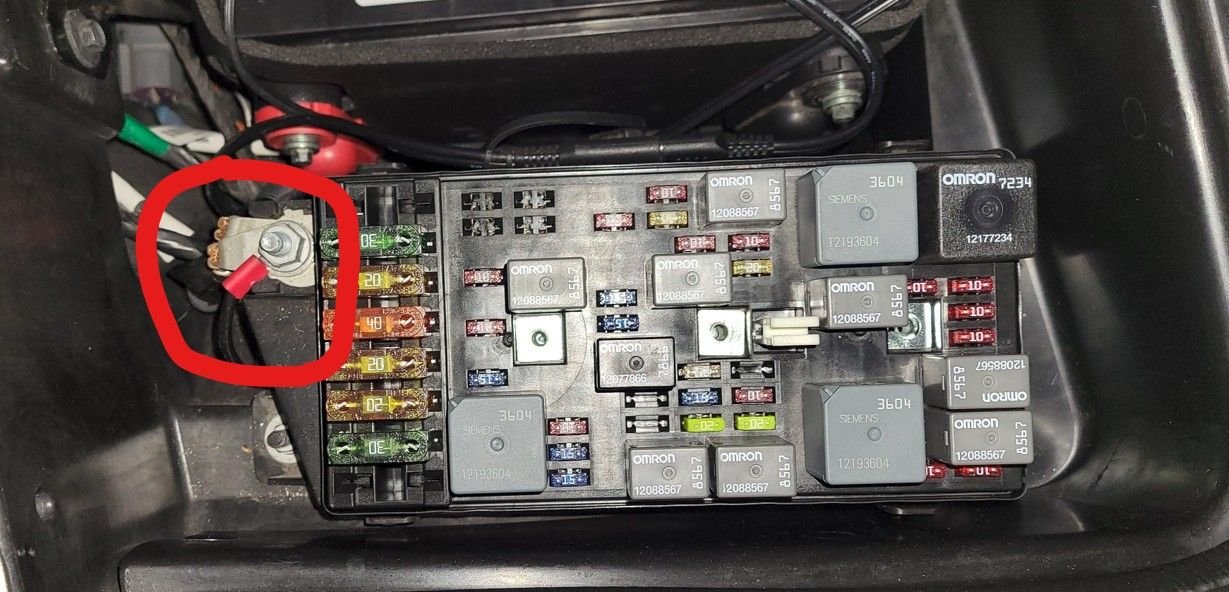

The underhood and IP electrical centers are directly connected to the positive battery cable. Remove the cover from the underhood electrical center. You will see two large terminals. One is from the battery, and the other provides 12v to the IP electrical center. You should have 12v there at all times. Check that nut for security .

Thank you all for the help and suggestions. As someone stated, it was the loose positive terminal. The odds of it getting loose and not contacting at that exact moment baffle me.I drive it every weekend and the positive never gave me issues. I am relieved to say the least that it was an easy fix. Thanks all.
