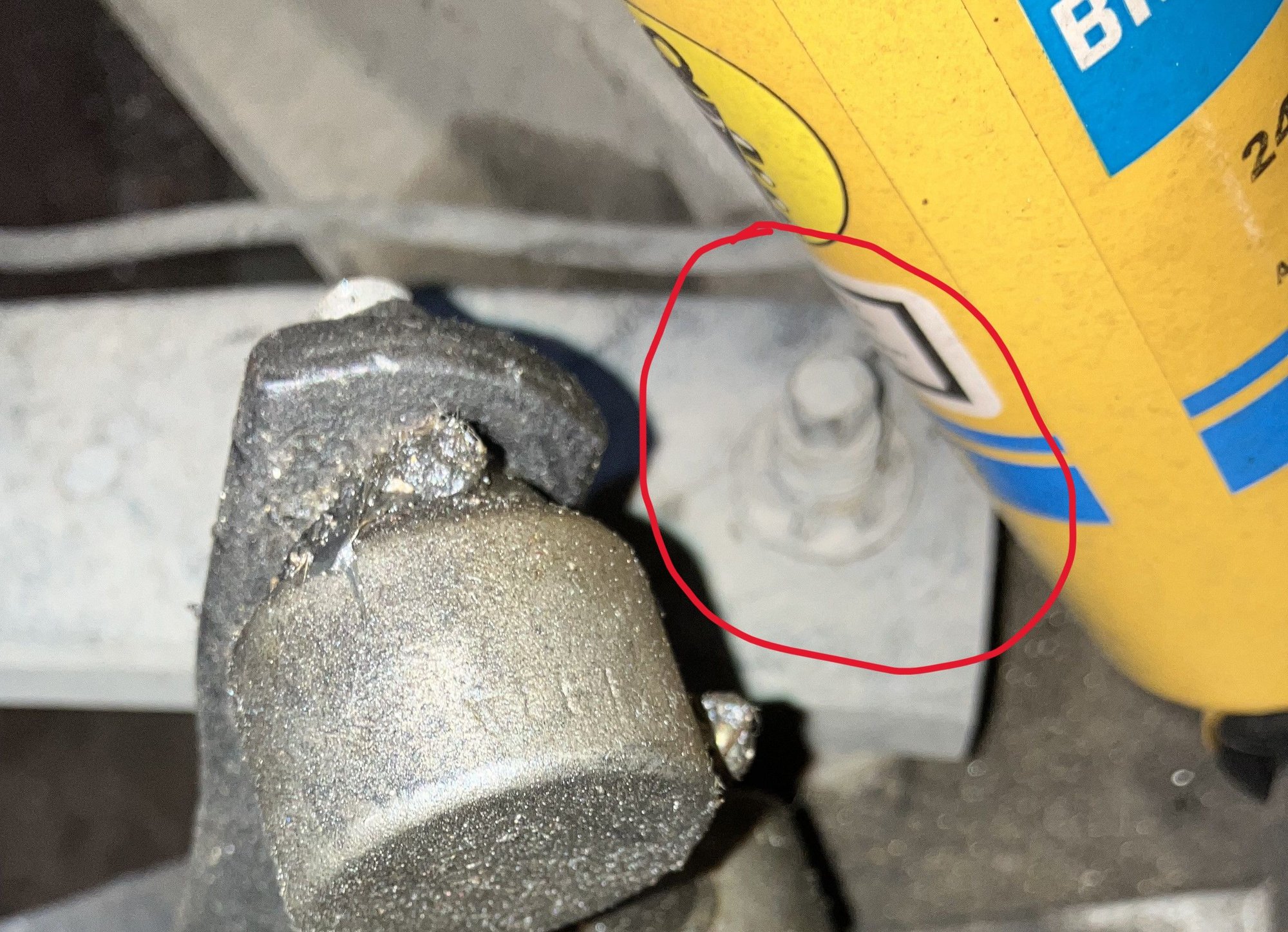

While I was getting ready to mount my new rims and tires (pics to follow when the weather get better) I was inspecting the front suspension and noted the threaded stud the front spring goes over seems to be missing a retaining nut. The only thing on the stud is the factory star washer retainer. Both sides are the same. So, is there a nut that is supposed to be threaded onto the stud? The leaf spring looks to be secure, just looked odd having a bare threaded stud. Oh yeah, if I do need to install nuts, anyone happen to know the size?

Front springs have no nut. They thread into a threaded insert set in the spring itself.

Thank you for that! the spring looked secure, just looked funny with that empty threaded stud sticking up.
