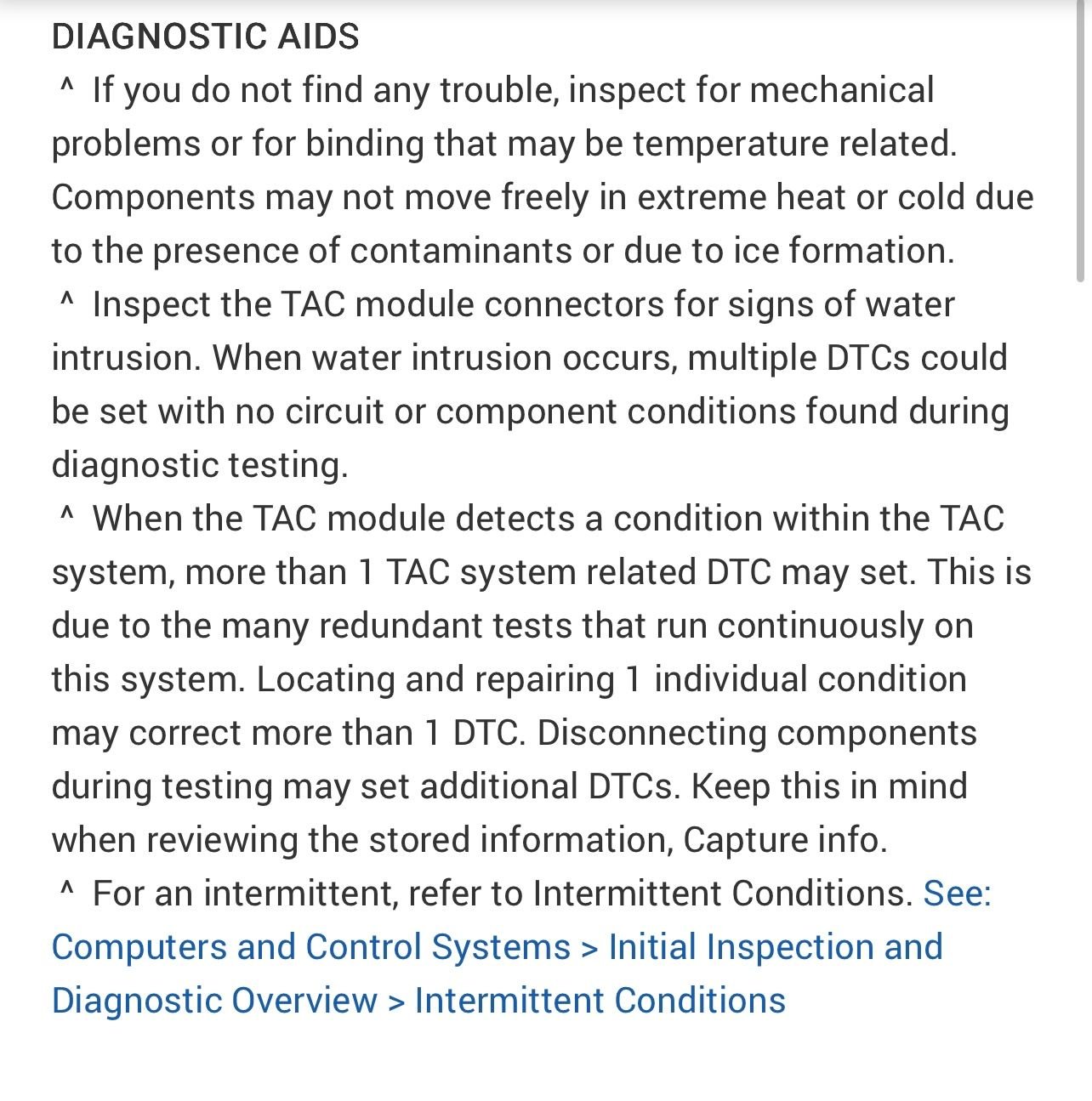

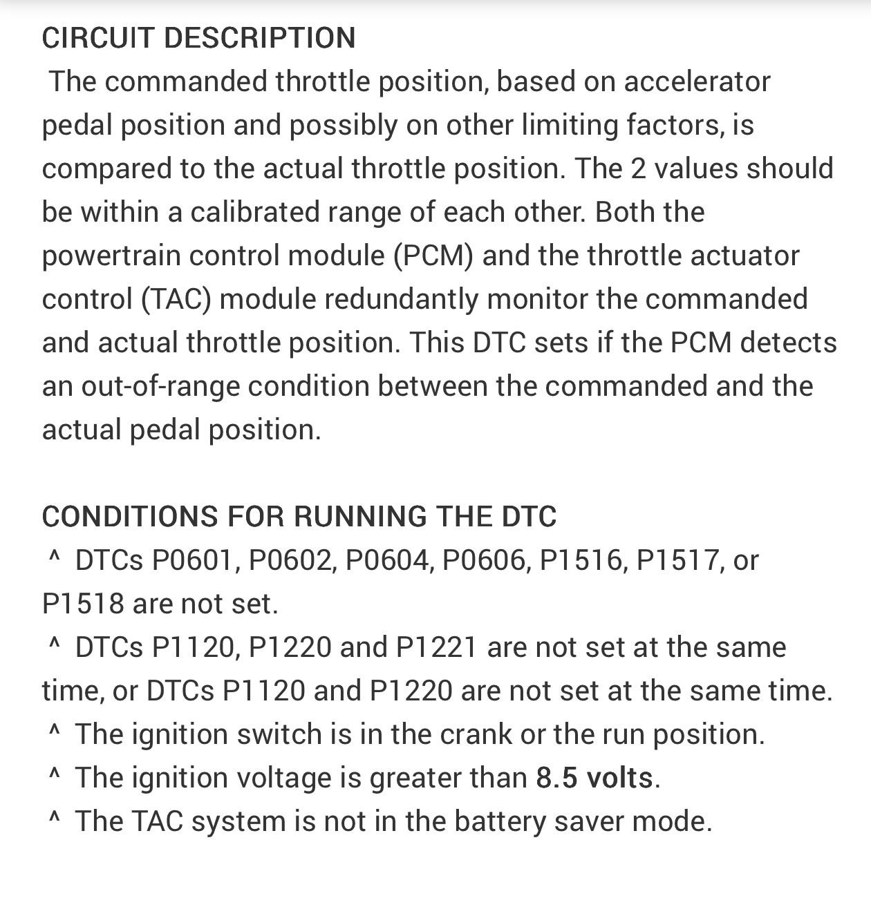

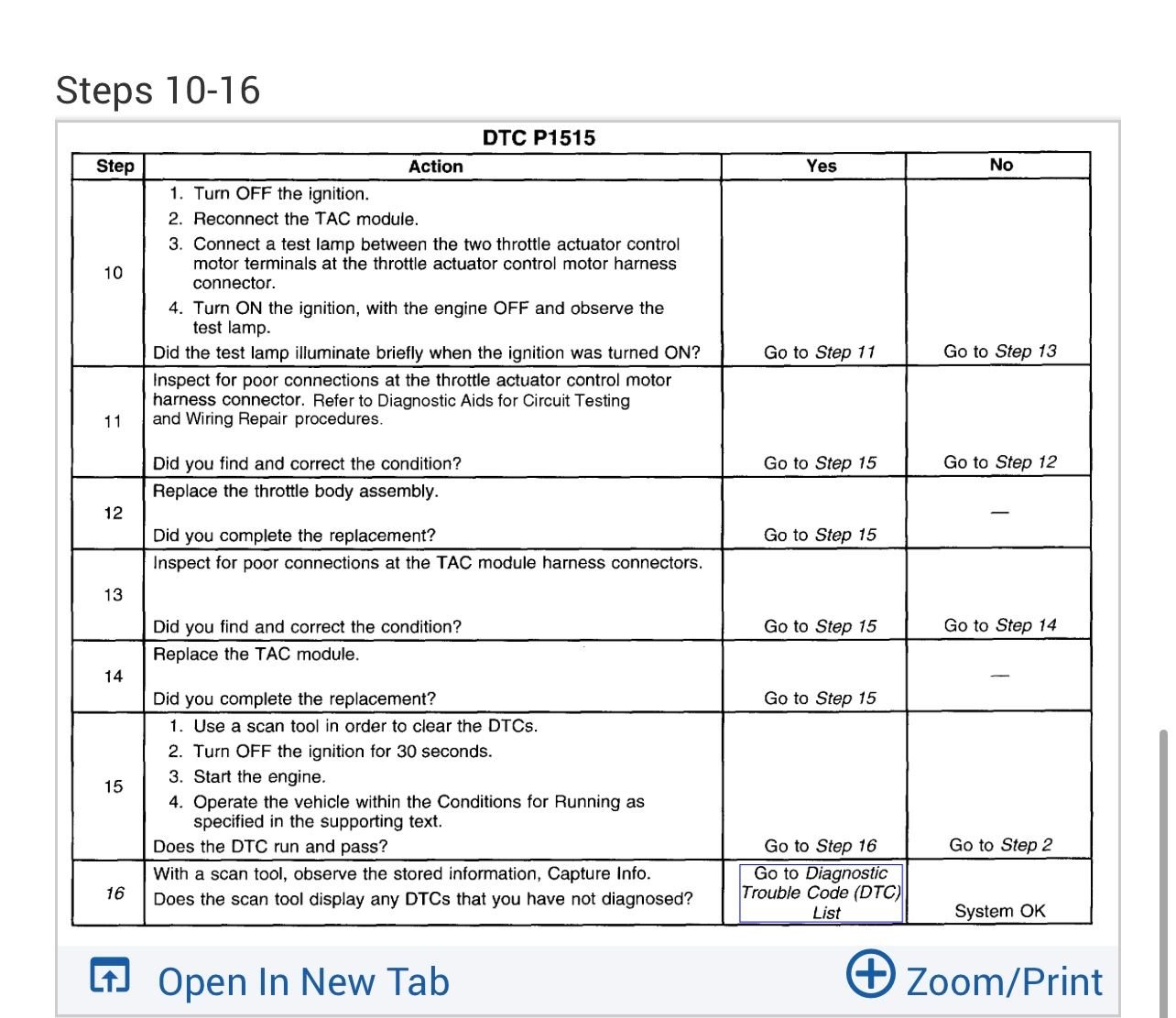

Old Apr 18, 2025 | 07:15 PM

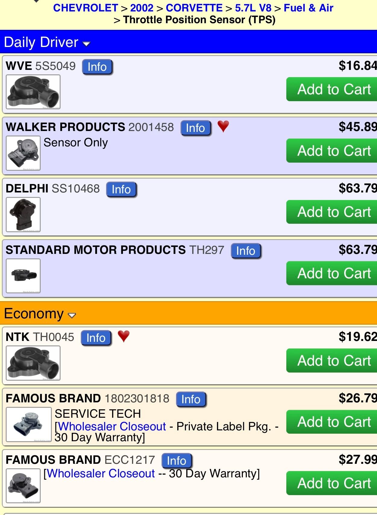

Who said you can’t change the TPS Sensor ??…I have NO idea what model year your car is but below is for a 2002 from Rock Auto…when you post ALWAYS tell us what model year you have as a minimum.

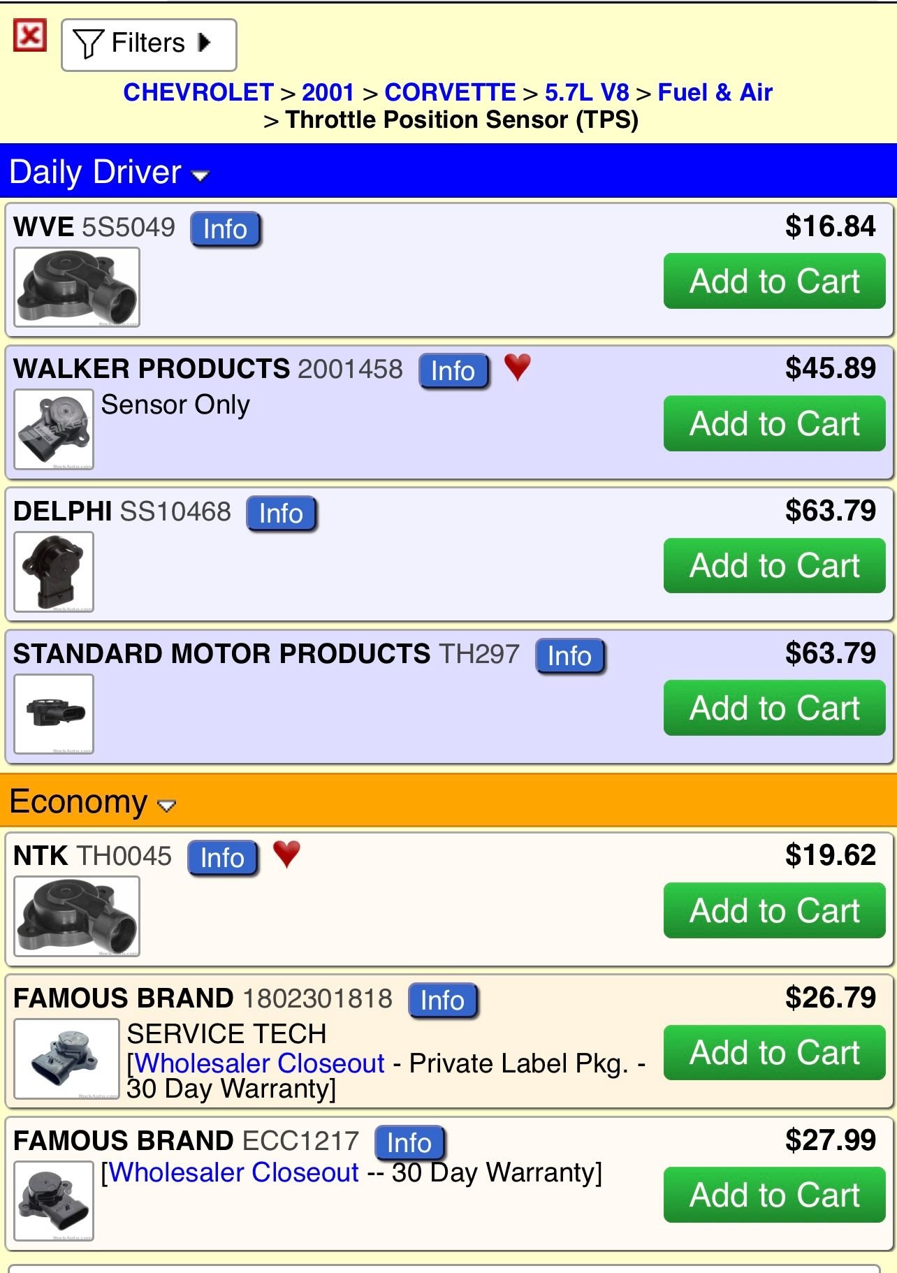

Here are some TPS Sensors for a 2001 on Rock Auto !!..if you want then change the TB.
