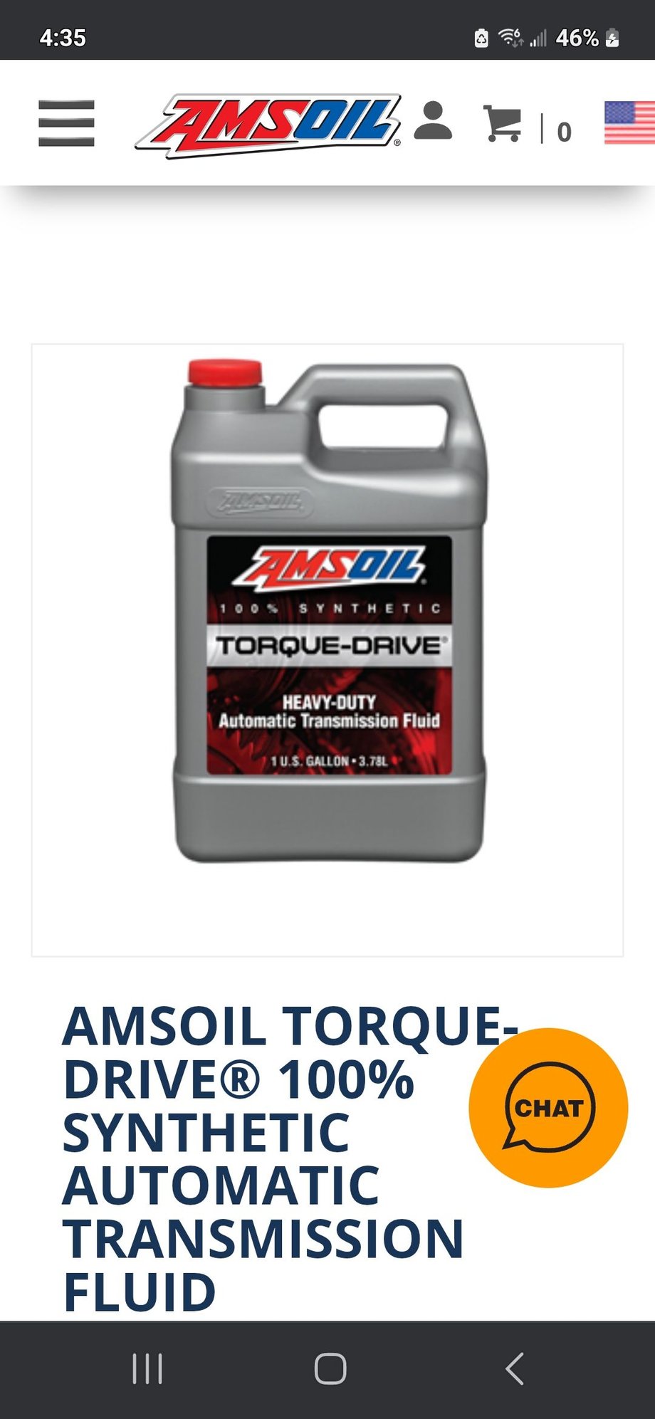

Amsoil Torque-Drive FTW!

I'm currenlty in the rabbit hole on this topic as I want to replace the fluid in my '99 manual trans.
The 8861800 seems hard to get, but may be the ideal choice for the older C5s with the paper syncros if you can find it. I've ordered it a few times from different places and was delivered 19540137 instead.
Had the Torque Drive in my garage, but didn't use it because it is synthetic.
Intrigued by the Mobil ATF as I've seen that posted before.
Has anyone run Valvoline 883786. This was availabel at local box store. Says Dex III, and recommended for vehicles before 2006.
