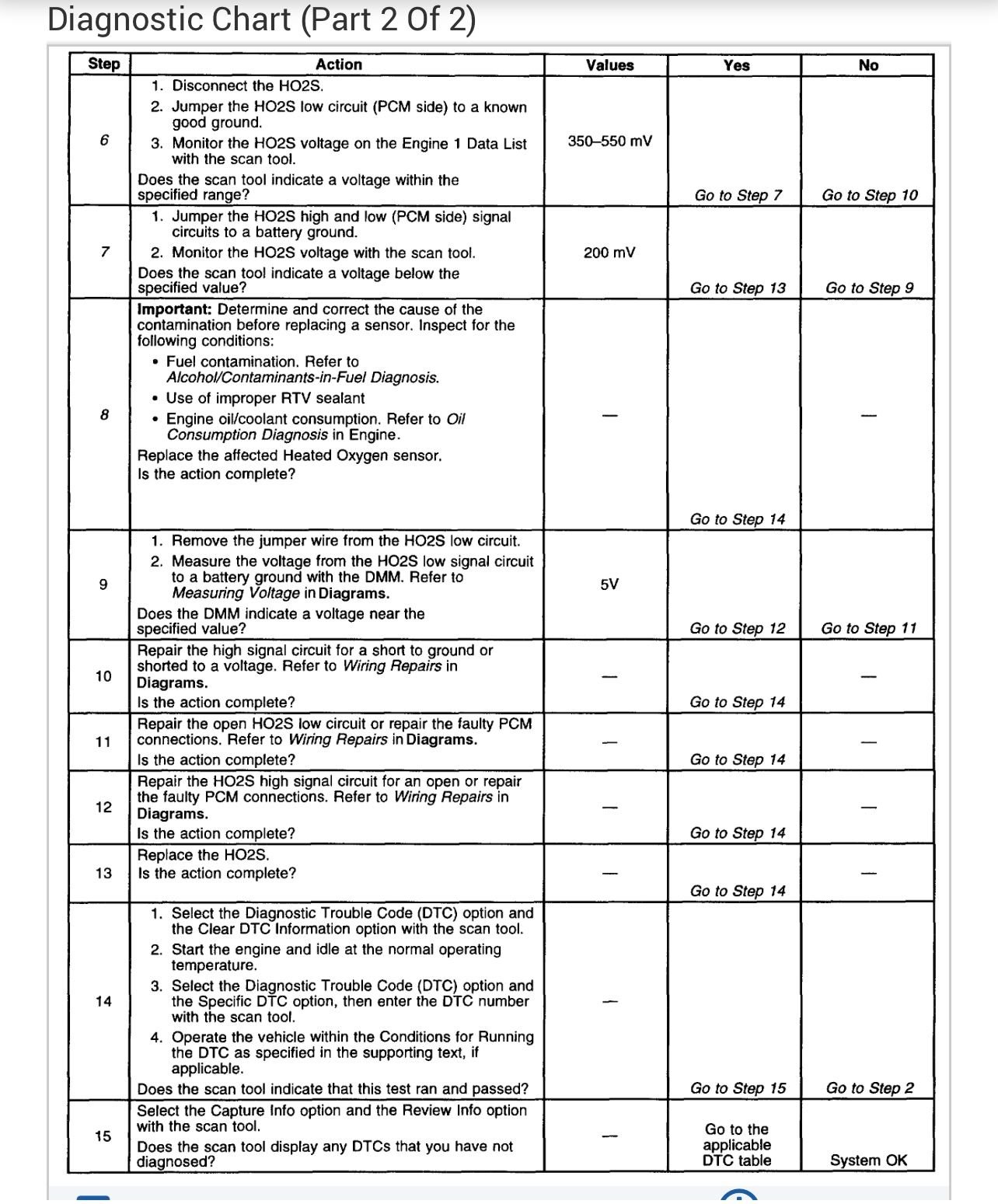

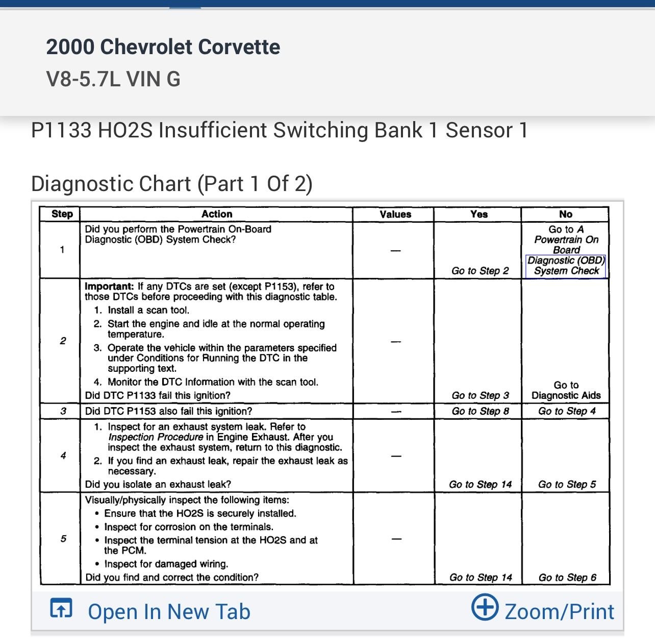

OK, here is the OE flowchart…read step 3 and then read step 8…fuel contamination or this thing is using oil or coolant…can even be a exhaust leak…was a comprehensive PPI done before purchase ??
