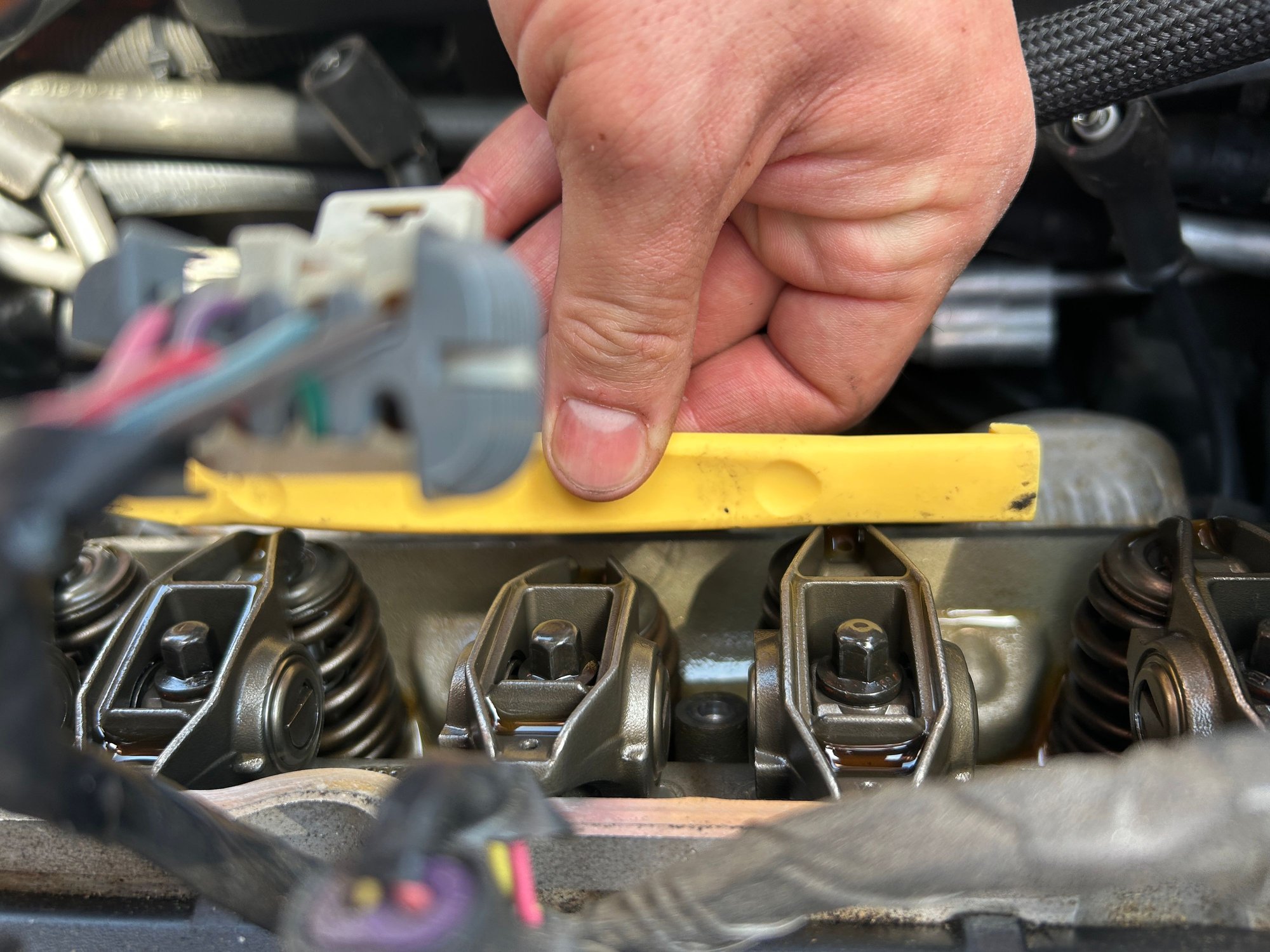

So to get a move on things, I took off my valve covers today to see if any of the rocker arms could freely push down the pushrod (and to see if my z still has the yellow springs). Luckily, no yellow springs and no vertical movement when pushing on the rocker arm where it meets the pushrod- just a bit of lateral movement on most arms (which I’ve read is normal). Rocker arms were all torqued to 22ft lbs.

2) Three of the springs on the passenger bank are notably more compressed than others. When examining the driver side, I could couldn’t visually distinguish a height difference across the springs. Do the pictures below show problematic springs that should be replaced?
Just to show the height difference, looking from the top of the passenger bank
Passenger side springs facing firewall
Pass side springs, pix 2

The springs should have various levels of compression they are all in varying degrees of opening and closing based on the cam/crank.
It sounds a little loud but its tough to tell from a video. If you do decide to replace anything just do everything at once and save yourself the aggravation.

I'm not going to make any claims based on an audio clip, but it does not sound like death noises.
Agreed with above. The rockers will depress various valves / springs based on the four stroke combustion cycle of Intake, Compression, Power, and Exhaust.
