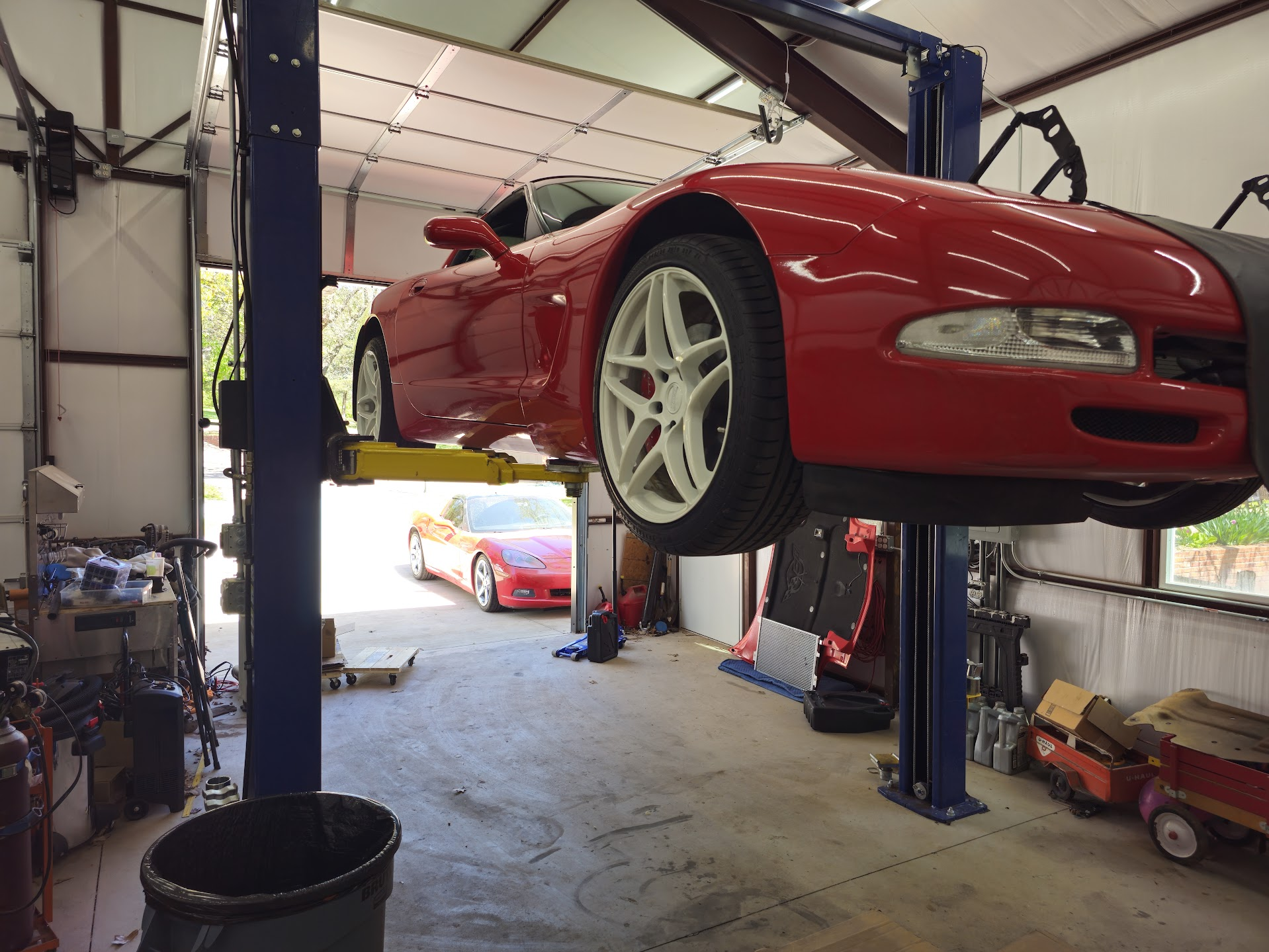

I took a lot more pictures at the beginning of the project as opposed to the "end" as I was rushing to get the car driving again but if you look closely at the beginning of this video you can see the dual fuel lines and the coil pack there hanging low is held on by some doubled-up zip ties
