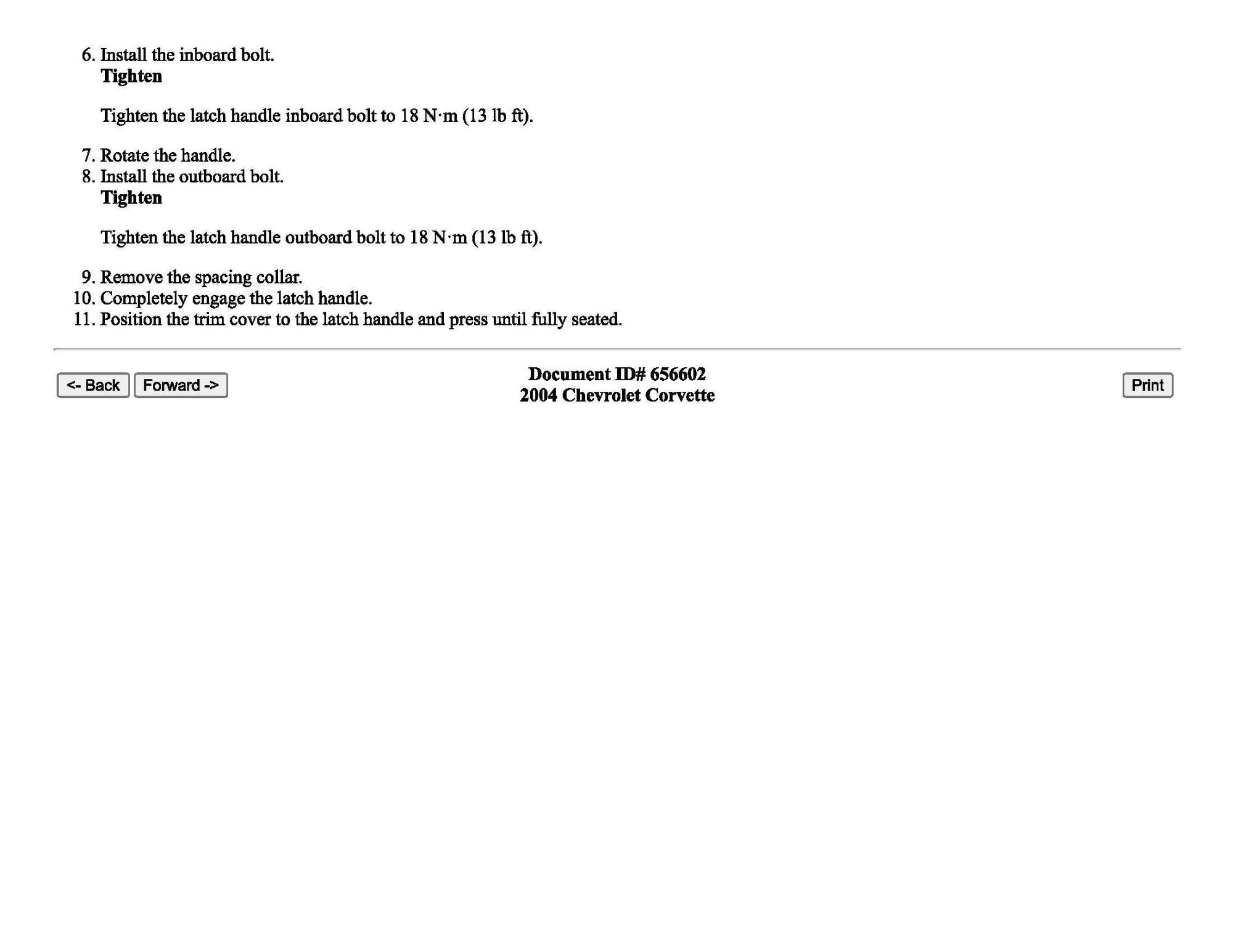

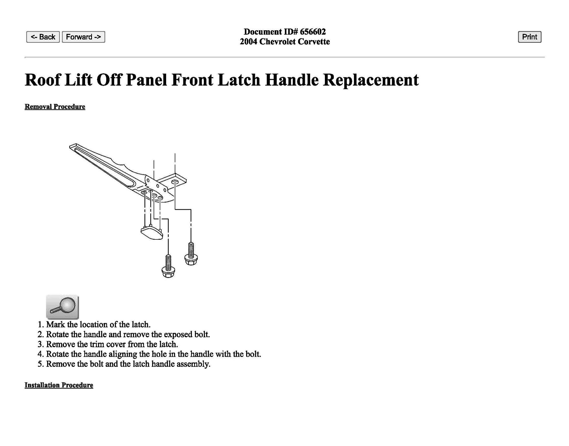

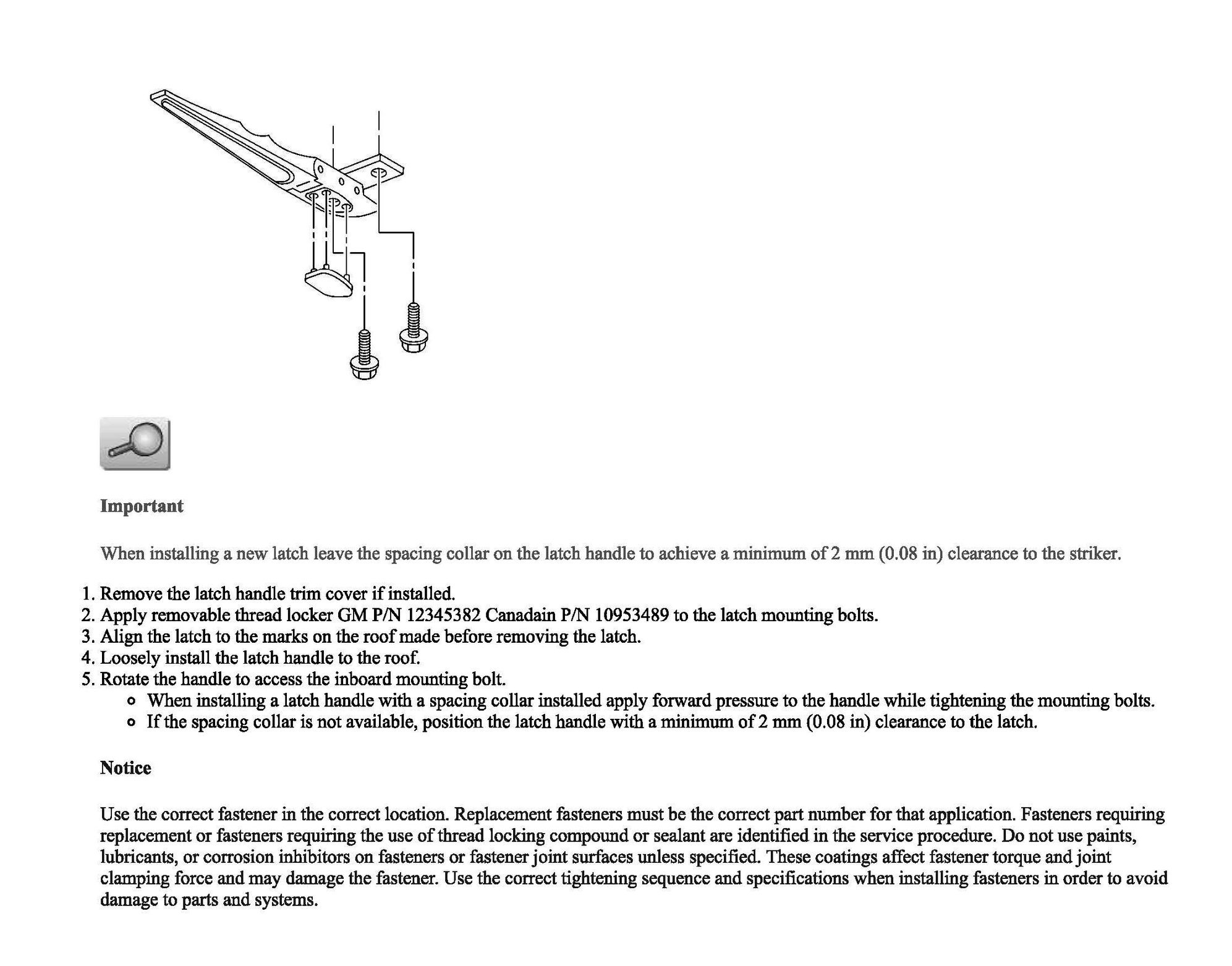

Any video or instructions on how to replace the latch would be helpful. Current latch is stuck and I ordered a new one but can't find any info on how to remove/replace (right side front). Thanks in advance!

Thank you very much; super helpful!

Where are you getting these docs from they are incredibly useful.

Thank you very much!
