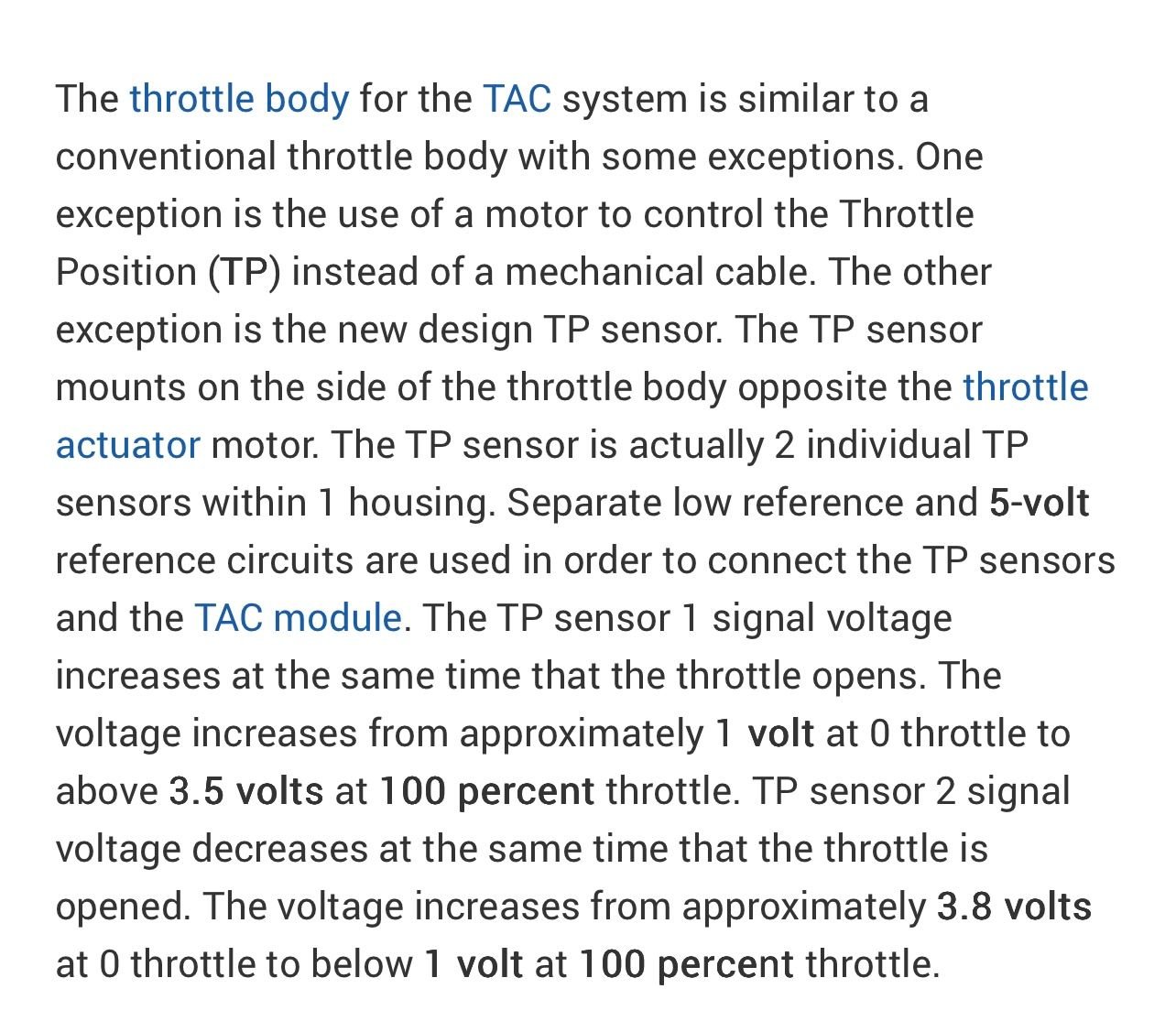

Read how the TPS sensor works on an LS1 top and LS3 bottom…the PCM is not seeing the voltages it expects from idle to WOT.
This is great information! Do you know what would be the remedy for this? Some kind of tuning or a different throttle body?
