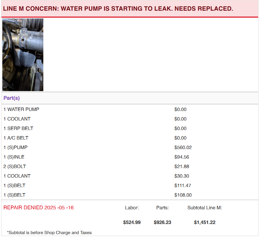

I recently bought my first Corvette, 2001 convertible, 6 speed! I've never been very handy with vehicles, but I told myself this car would be the one where I learn to do as much work myself as I can.
After taking it to a dealership a couple days after picking it up, I've been quoted $1500 to replace my water pump. I don't see where this pump is leaking from. Does anyone know how difficult this will be? Looks like there's more parts I need to replace (e.g. belts) than I've seen is some youtube videos. Thanks!

It’s not too bad, I’m about to replace mine because I have a small leak, touching underneath the water pump with fingers it was wet.
When I replaced the A/C compressor had to remove the water pump to get room to pull compressor out and put new compressor back in, at the time 2018 the water pump was fine so just replaced water pump to engine block with new gaskets.
Drain the coolant, remove serpentine belt, remove the hoses from water pump, and I believe 6 bolts and pulled it off, then clean up the block put new gaskets on with water pump and hook everything back up.
Replaced both belts and all idler and tensioner pulleys in 2017 before going on out of state road trip, the belts were really cracked looking on the inside grooves, replaced all the pulleys because something had a squeak, no squeaking noise after all that.
Will inspect hoses and if look ok will reuse.
In your video it looks like a possible leak or crud buildup where thermostat housing bolts to the water pump, but you may have leaking weephole on water pump also, I believe my water pump weep hole is leaking.
Good time to also flush out your old antifreeze while in there.
I could be wrong, but your harmonic balancer pulley looks like it might have a wobble or vibration?
Might consider replacing that as well, it’s a known issue on these cars as they get older.

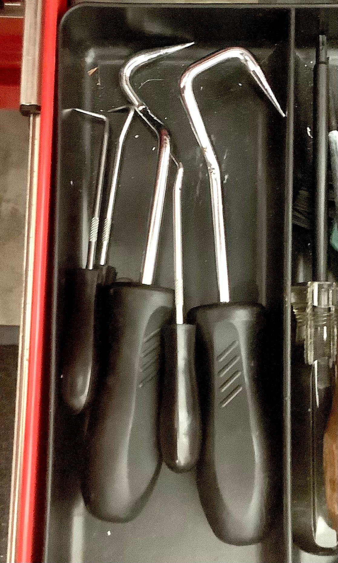

Get yourself a decent pick tool set. Removing the heater core and radiator hoses from the water pump after 20-some odd years will require sliding the pick (i usually use the 90 degree one) to help break the seal between the hose nipple and the hose itself.

Picks, both big and small, make life easier working on the C5.
