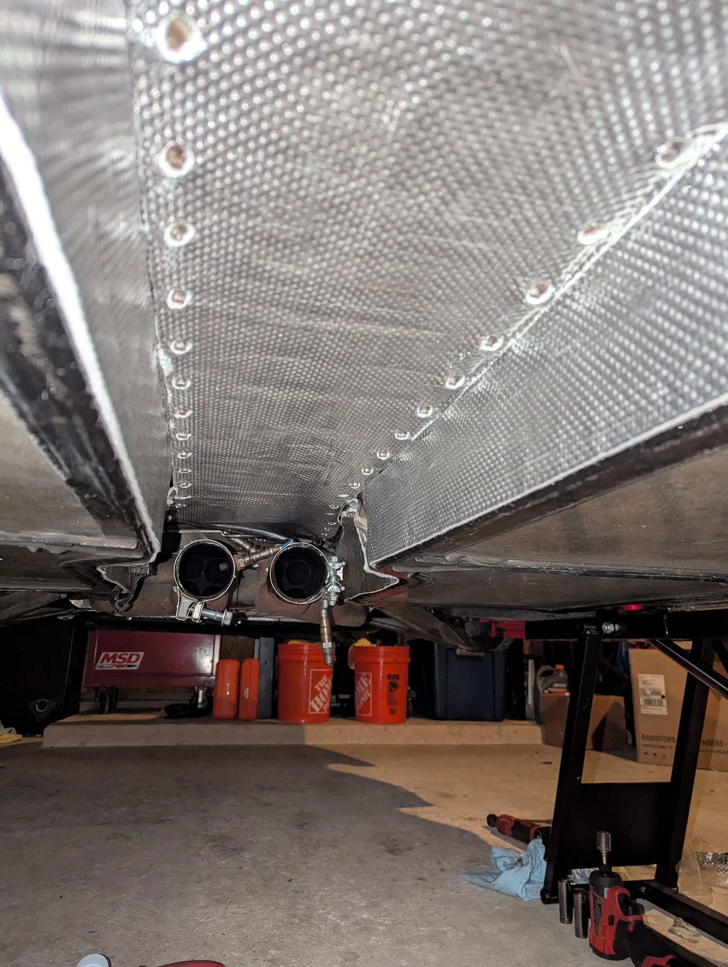

I also installed the DEI insulation kit a few days ago. It got hit with a 408ci and 3
I also installed the DEI insulation kit a few days ago. It got hot with a 408ci and 3" exhaust, and no A/C!
