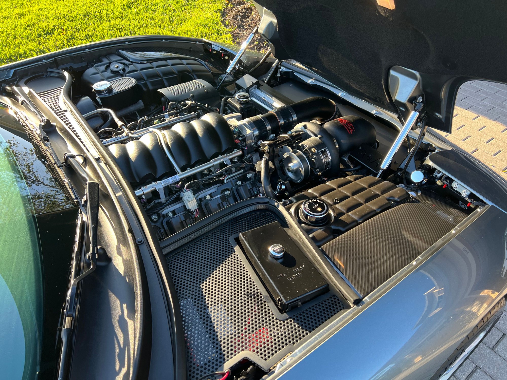

I just performed this swap into my 2004 convertible last year as I hydrolocked my supercharged LS1 in less than 6 inches of Hurricane Debby storm sewer overflow water less than two miles from my home. Below is a link to my story:
https://www.corvetteforum.com/forums...d-odyssey.html

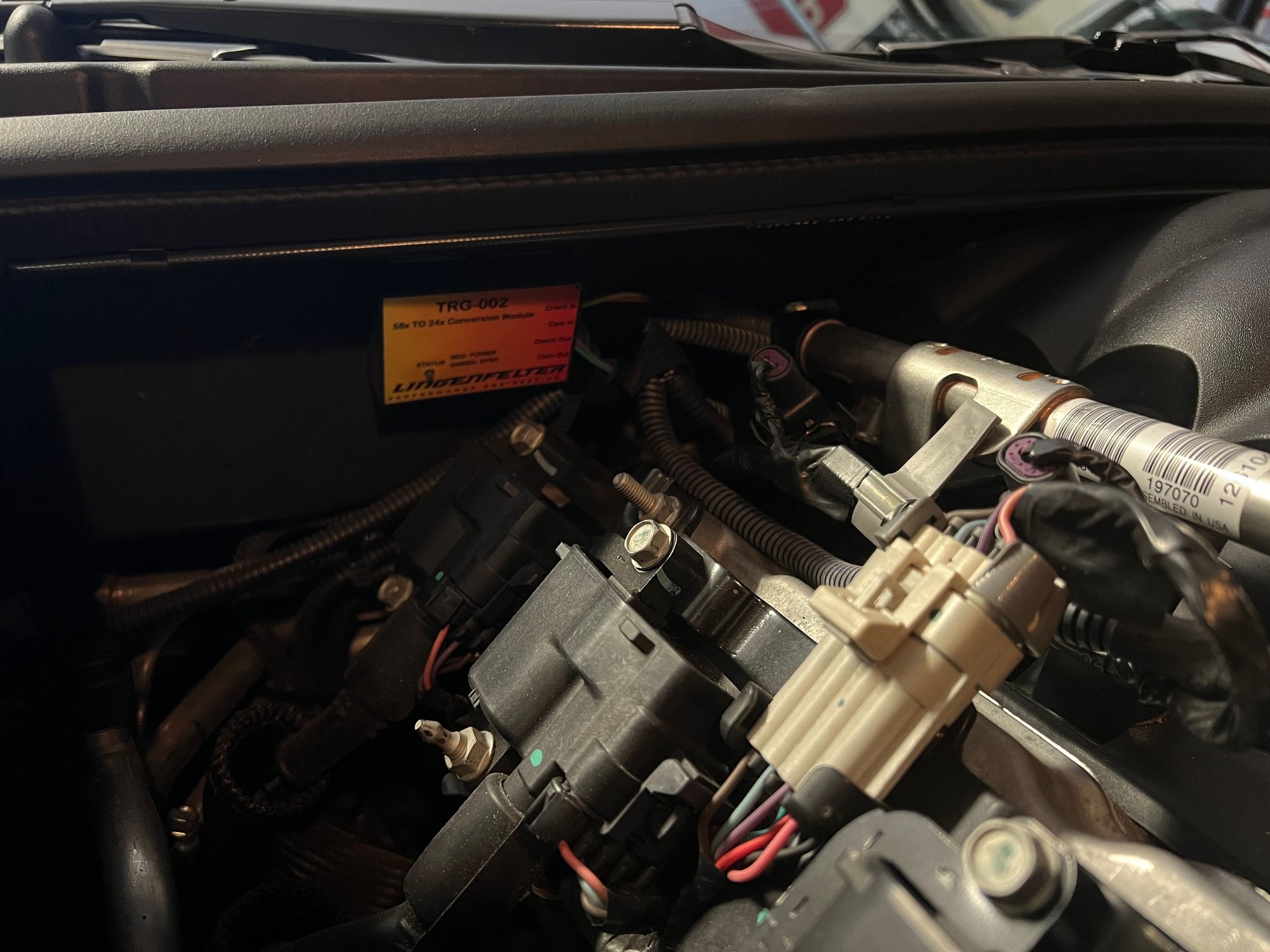

Because my set-up is supercharged with a custom grind cam and headers, I needed some additional parts, however a straight LS1-LS3 swap should require mostly new gaskets, valve springs, T-stat/housing, sensors etc. In addition and most importantly you will need a Lingenfelter TRG-002 LSZ 58X-24X Trigger Wheel Conversion Control Module kit. Below is a link to their website/video explaining the unit:
https://www.lingenfelter.com/product/L460065397.html
My unit was mounted near the windshield firewall next to the battery den.
