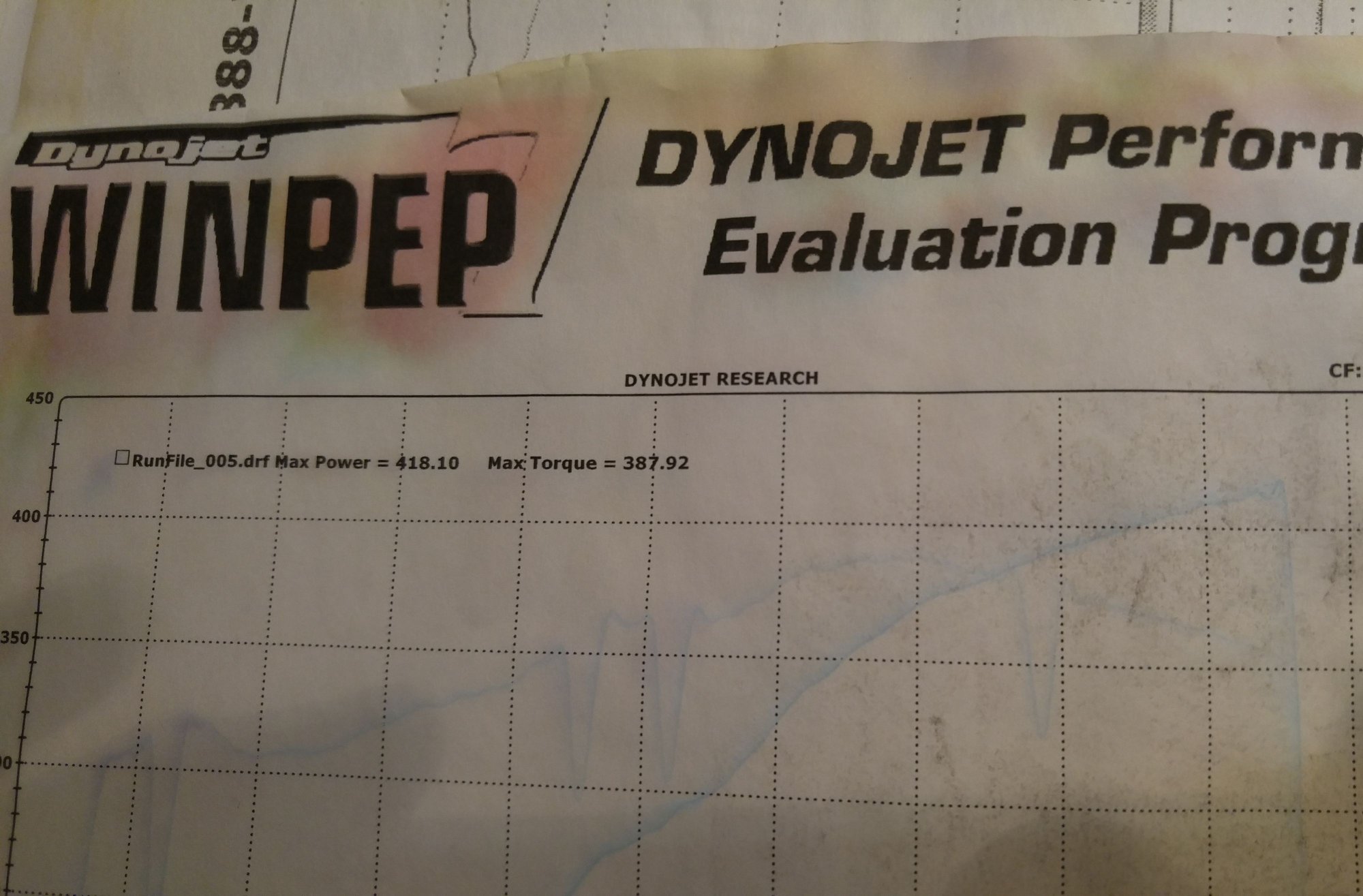

Here is one of my dyno sheets with the 228r, ported 241s by WCCH (back in 2003), and short tube BBK headers. With 3.90s my car was a blast to drive until I blew it up. Especially after replacing the "LS7 clutch" with a Centerforce DF.
Shortly after smoking cylinder 7 on that build I went with the 232/236/113+2 custom grind from Cammotion. Coupled with 4.11s and Kooks 1 7/8s and offroad x-pipe the car was a fun NA screamer at 418whp. That was on stock '99 injectors. It made 428rwhp with stock '01 injectors. (Ignor the sporadic lines on the printout, the tuner, Bill from 2nd Street Speed in Perkasie PA, was having issues with his graphs printing).
The peak power difference between the two cams was minimal. And after adding the Kooks LTs and off-road x-pipe I gained 28rwhp. Which is why I am suggesting above that LTs only is a big fat waste of money unless sound is your primary goal.
