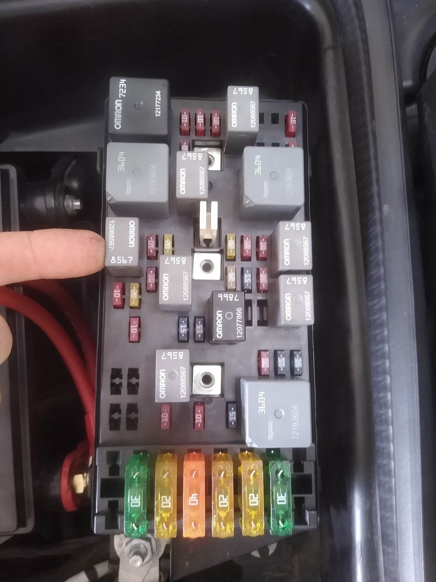

Ok, Silly (maybe)
question..
in the attached, the relays are all in the same orientation except the fuel pump relay. Is there a right / wrong orientation for the 8567 relay ?
Thanks
Ron

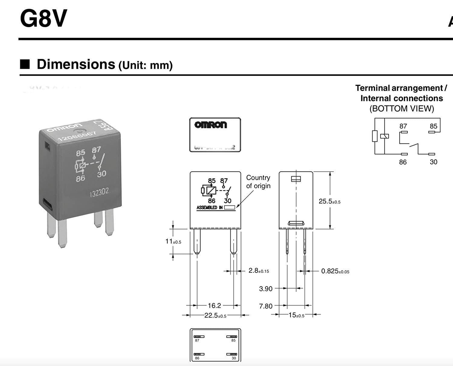

Yep, silly.
The relay coil wants 12v or ground on contact 85 or 86, it does not care which. Contacts 87 and 30 are just connecting line and load side.
