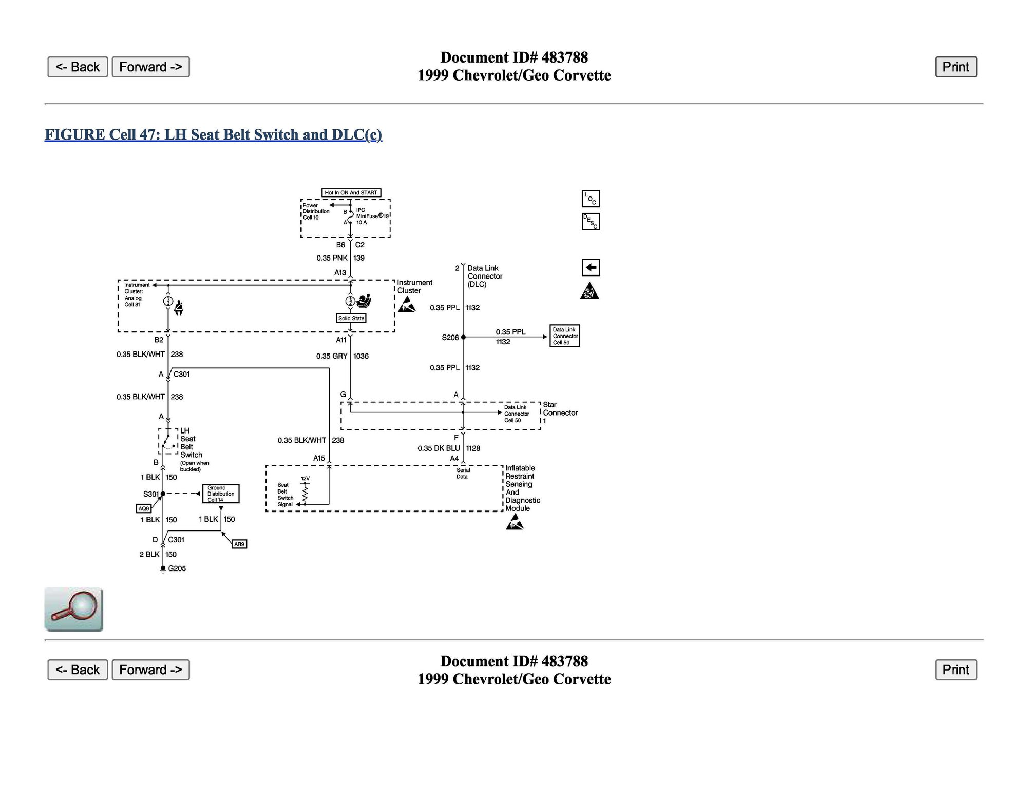

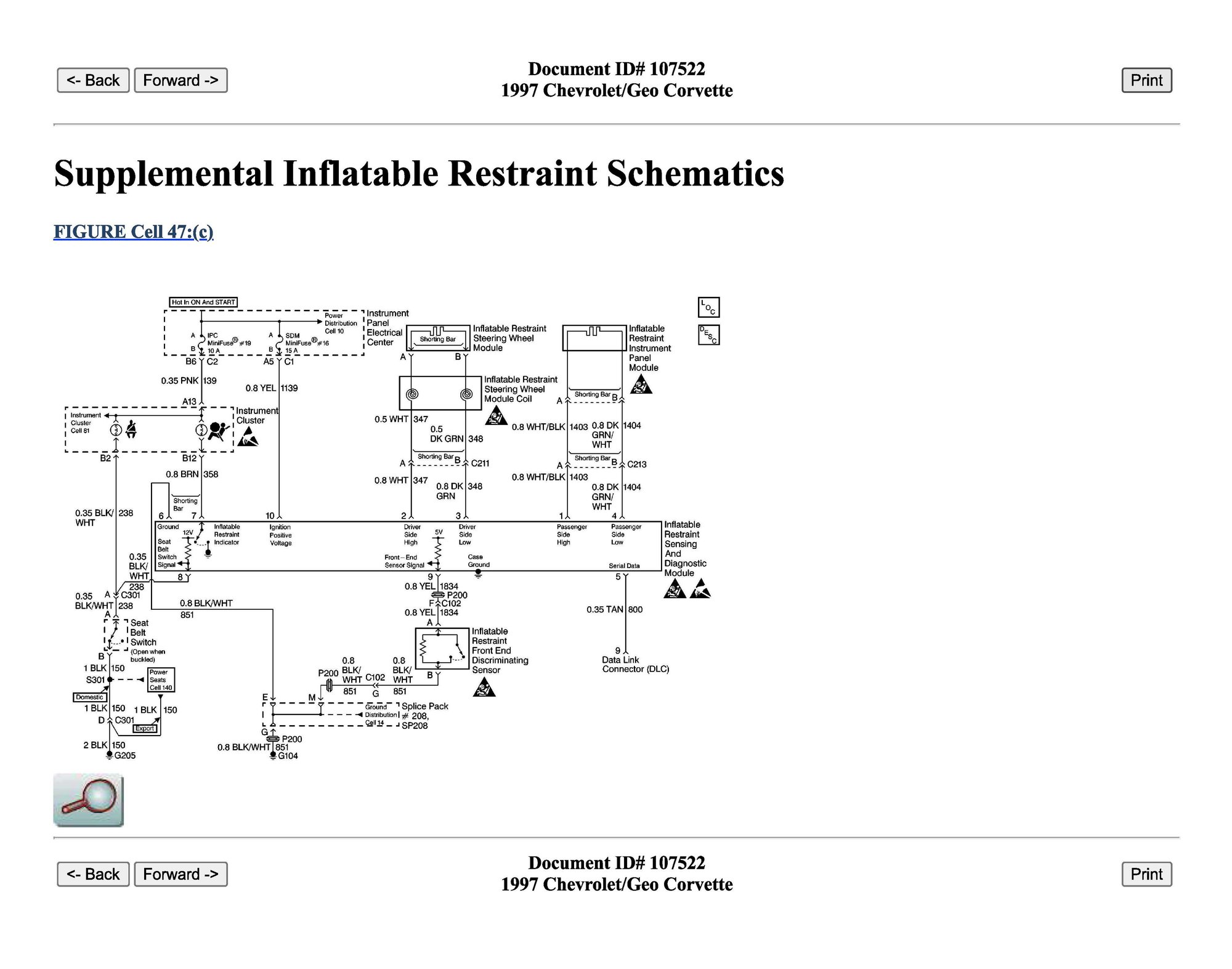

That's your problem. The SIR components changed in 1999, and the airbag light is controlled differently in a 97-98 IPC. The light is controlled in a 1997-98 by the SDM providing a ground. The SDM changed in 1999, and the light is controlled via class 2 serial buss. The SDM in a 1997-1998 is not even connected to the class to serial buss.
