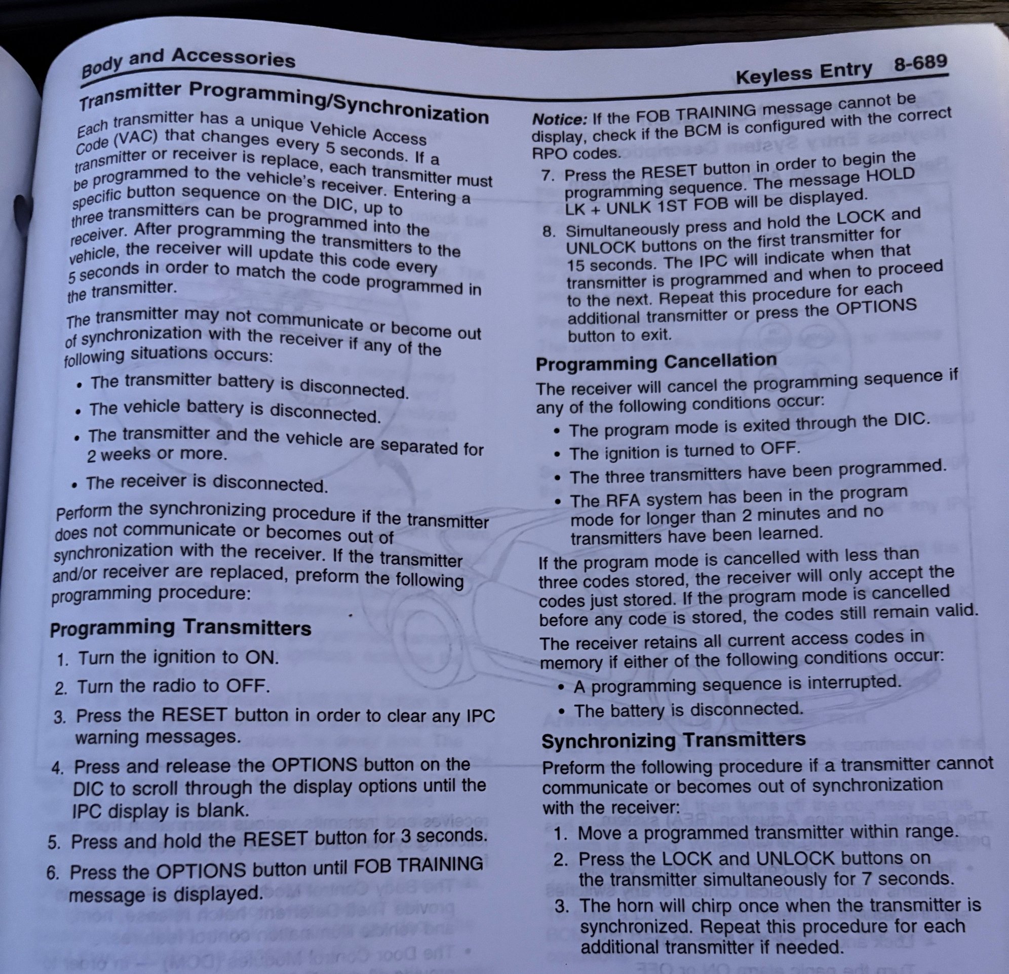

This is what supposed to show up and does not. This is at the end of the programming in the video, After pressing reset.

To be clear, the "FOB TRAINING" does appear but it will go no further? Here are the instructions from a 2000 service manual.
The attached document appears to be from a 2004 supplement but the programming process looks to be the same. If you have access to a scan tool there are troubleshooting methods one can try.
File Type: pdf

[QUOTE=Dads2kconvertible;1608996016]To be clear, the "FOB TRAINING" does appear but it will go no further? Here are the instructions from a 2000 service manual.
The message HOLD LK + UNLK 1ST FOB doesn’t display, so that seems to be the issue. But I don’t know how to remedy that. Perhaps a scanner will work but now I have to figure out how to drink one of those! 😅 ( Ty for pic! )
While FOB TRAINING is on the screen what happens when you press the reset button located at the bottom of that column of switches on the right side of the dash, under the E/M button?
When RESET is pressed it stays on FOB TRAINING. And I know I’m doing it correctly because I had my brother’s friend. Take a look at it just to make sure. It’s just that last message that’s supposed to appear doesn’t. So I’m guessing that’s why it won’t program.
( I also added a photo in the original post. Of what should be appearing after the reset is pressed .)

So I'll say this one more time, and I'm out.
You do not need to enter the programming mode through the DIC for a previously used FOB. You only need stand next to the car, no key in the ignition and hold lock and unlock buttons down until the horn sounds(provided the horn is not turned off in the DIC.....consult your owners manual) This may take some time, so be patient.
You may also have extenuating circumstances, so you should post your codes:
Does the reset button work for other things? Maybe the button is broken?
