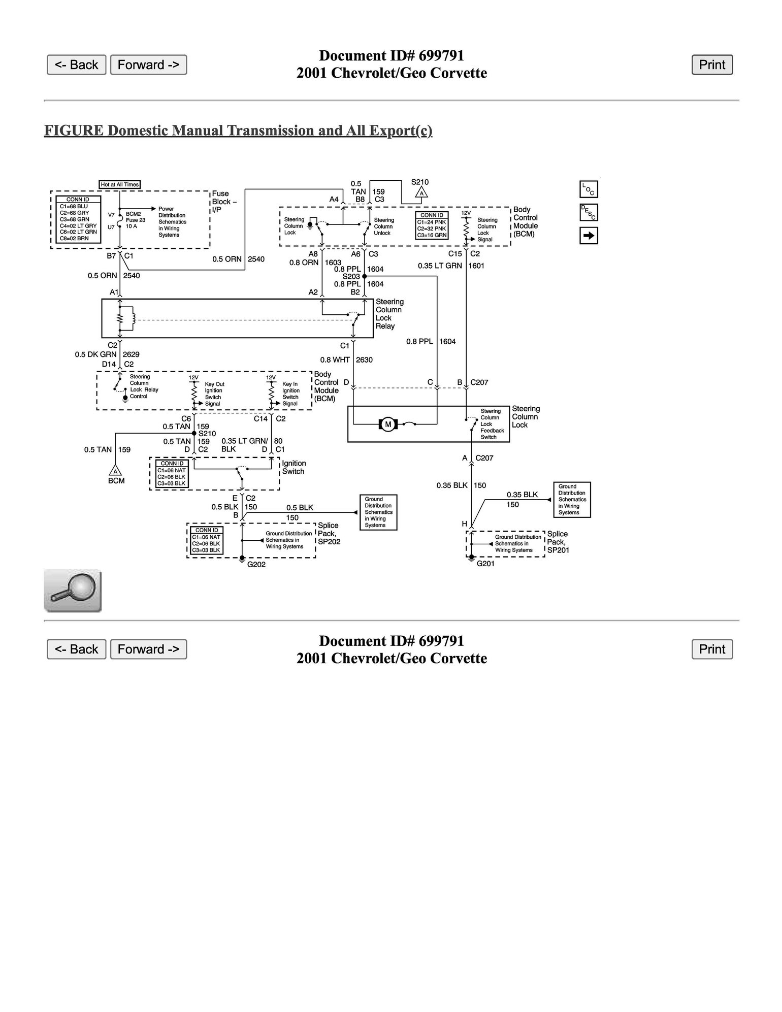

Ok, so based on what you are describing, the contacts in the ignition switch that tell the BCM a key is inserted may be an issue. The BCM monitors three things : 1) Key is inserted in ignition (provided by ignition switch plunger) and provides a ground to the column lock circuit 2) Monitors the column lock circuit (simulated by the CLB) for faults. 3) determines status and will take action i.e. tell PCM to disable fuel......PULL KEY - WAIT 10 SEC......etc.
You can mointor the resitance to ground at the BCM connector. Worth a look.

No. The key resistance is read from the lock cylinder.....not the ignition switch. Not able to read the schematic?

I would like to know the troubleshooting steps he took to isolate the BCM being bad. Especially because you have a repeatable issue that can be duplicated by only manipulated the key.
Don't get distracted by random "check the grounds" suggetions. Just use the schematic to isolate.
