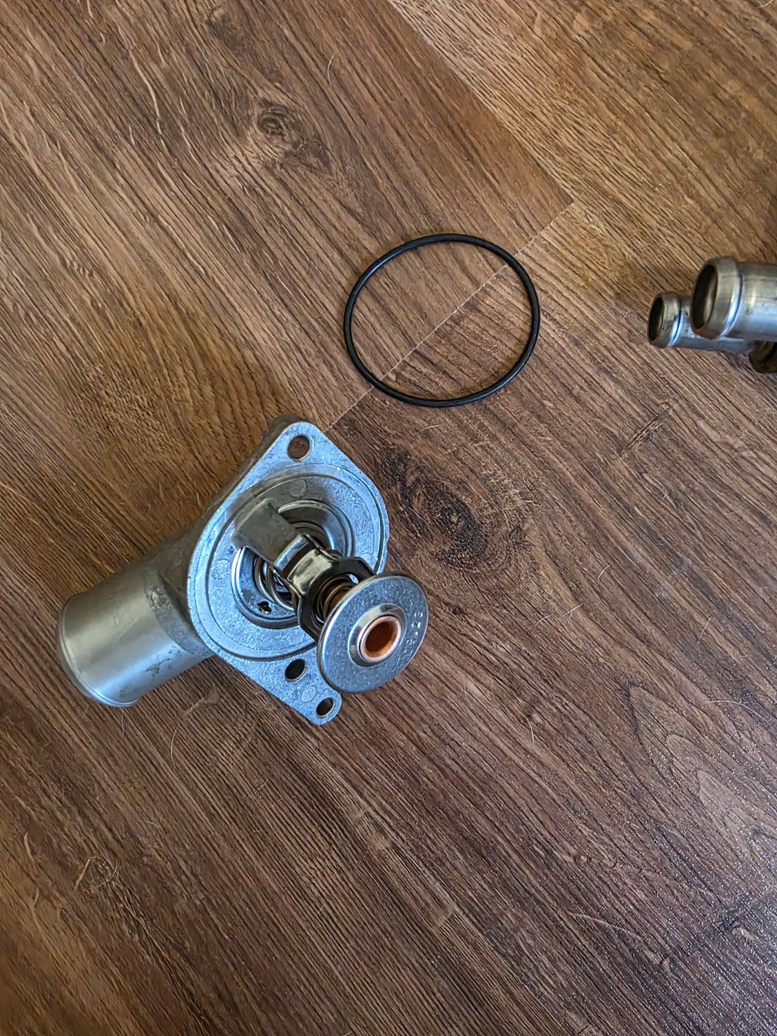

Yes, I am sending photos. 1. The original water pump that was on the car. 2. The thermostat that did not fit into the original pump but did fit into the new one. 3. The new water pump that is currently installed on the car. I installed the original thermostat with the flange on this pump using two screws.Before fastening, it was necessary to slightly press the thermostat with the flange against the spring, as the thermostat was already touching. It only needed to be pressed about 3 millimeters.

The thermostat temperature is now not too high. I’m still thinking about that pump. It also occurred to me that the pump I put in is the older model — the first type that was made. That’s why it could fit both the 3-screw (one-piece) thermostat and the 2-screw thermostat. I installed the 2-screw thermostat (the new type that can be disassembled). But that would make sense — it’s simply a new part, but it’s not the new type of pump, it’s the original type of pump.
What do you think? Because if that’s correct, I’ll just keep this pump and install the 3-screw (one-piece) thermostat instead. I’m just not sure whether the new type of thermostat can also be used there or not.

First off, the boss that looks like a third bolt hole isn’t a bolt hole. Ignore it. Cut it off if that makes you feel better.
The pump you show looks to me like it will accept either the early one piece thermo/housing unit or the later two piece that became std on the trucks.
the thermo fits into the housing, and acts as the gasket as well. No stupid O-ring.
And yes, the stat hits the bottom of the hole before the housing hits the pump. Just hold it down while installing the bolts.

Thank you for your response.How can I find out which thermostat I should use? Since my pump can fit both the older and the newer type The older type of thermostat did not make contact with the pump the way we describe it with the new type of thermostat.

I’d use the later style.
