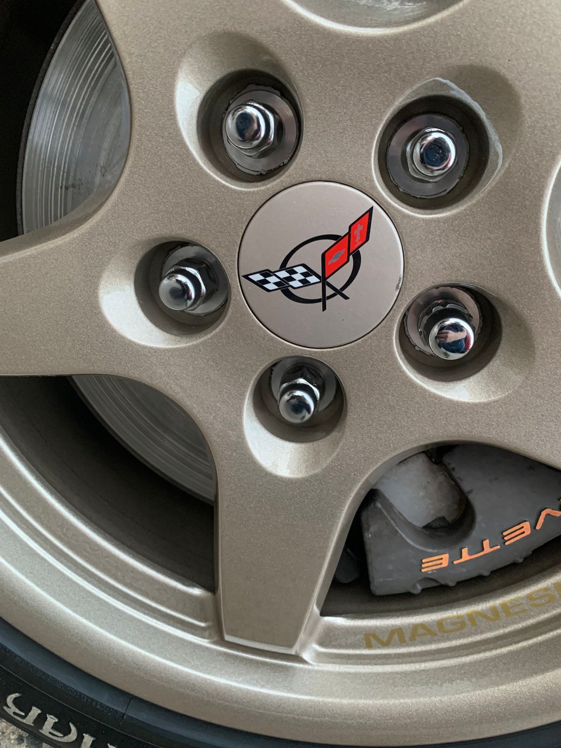

Hey guys,
Has anyone here run into this issue with the magnesium Speedline wheels offered on the C5? I’m talking about the pressed in inserts for the lug nut studs mine recently failed.
I had my car in the shop for some maintenance and when I got it back I noticed my front wheel was wobbling. I pulled it off and to my surprise the inserts had broken. Looks like the shop used an impact gun on the lug nuts which stretched the inserts and eventually caused them to fail. Two were completely broken and the other three were badly stretched.
I couldn’t find replacements anywhere online so I ended up making my own out of 7068 aluminum. I pressed them back in with grey silicone and so far they’ve been fantastic 1000 miles later they’re still torqued perfectly the angles for the cone on the lugs and wheel
match the originals and everything has been solid. I also gave mine a slightly smaller inside diameter for added strength compared to the originals which were cast.
If anyone needs some for theirs I can help make and ship them.
Just curious has anyone else had this happen and if so how did you fix it?

The inserts you removed should have been steel. While the aluminum insert you fabricated is harder than the magnesium, it's not harder than the lug nut. I have never seen an aluminum wheel insert.
By factory all the c5 magnesium wheels have aluminium inserts, Ive never seen a steel one before, IIRC it'll oxidize, aswell as on the base wheels they dont come with inserts just the casted aluminum.
You've never seen a steel insert for an aluminum wheel before? They are widely available.
Yes, steel is more reactive than aluminum with Magnesium, but I do not recall the level. Everything oxidizes.....especially bare metal like the inserts you so nicely machined. If the inserts were over-torqued, I would be inspecting the wheels for evidence of cracking. They really destroyed that one for sure.
True I ment ive never seen steel inserts on c5 corvette wheels before, I did check the wheel itself for any damages and luckily there isnt any signs of damage and yes my inserts would tranish too but not to an extreme like steel
