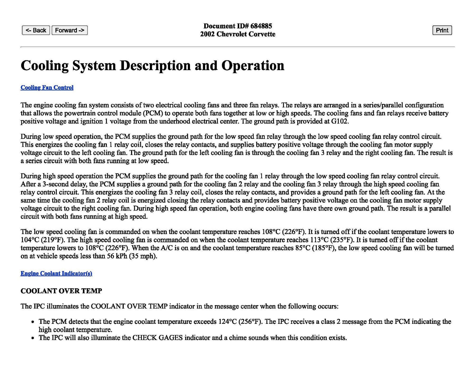

Lucky: correct, no issue at any speed above 35+/-. Only in town driving where speeds are normally <35.
So I'll reset the fans on/off using your low speed on at 226+ and off at <219; and high speed on at 235+ and off at <226.
You indicated that the low speed turns on at 185 below 35mph. Is that built into the circuitry? I ask because there is no table or switch in the HPTuner program that I can find to set that condition.
If I can't establish that low mph speed condition, then wouldn't it make sense to set the low speed on at 185? Since I live in such a year round warm climate I don't have to worry about cold weather warmup.
Already provided.....and I explained that the text was directly from the service manual for your year.

To the OP, the PCM/ECM recives a signal from the VSS vehicle speed sensor and uses it to turn on the fans at speeds below 35mph, and of course to turn them off at speeds above 35mph. I do not believe that that is a configurable parameter.
Hptuner you adjust all parameters. Speed, temp, A/C psi.
Turn on low speed high speed whenever you desire.

Lucky: I believe low speed turning on at 200 and off at 180, and then stepping up to hi speed at 215 and off at 195, isn't same as on at 180. Not sure what I said that misled you to that idea. The spread indicated are those that I used which were provided from the HPTuners maps.
Book: Your question has some validity for sure based on the inputs I made. But to be more clear: when I first brought the car to Hawaii after having no issues with it in Ca, I experienced overheating as I started making some mods not allowed on street cars in Ca. Did the normal hopup of headers, air intake, throttle body, larger intake manifold, highlift rockers, and custom tune. Worked very well, except in the higher temps in town. So I made the rad and fan changes. That dropped the running temp by 15 degrees. But intown was still too hot. Not always, but an issue when the temps were over 95 ambient. Another point is that the engine would not overheat just idling so it is an issue only when driving at low speeds.
Do these facts alter your thoughts on what I should be looking for, or what I might ask the shop to look at when she goes in?
It reads like if you drive at 36mph, you have no concerning coolant temperature issue. If you drive at 34mph, you experience high coolant temperatures. So what happens at 35mph? The fans in a stock configuration are turned off.
Here is an experiment for you to consider: Disconnect your fans (or pull fuses perhaps), and with the a/c off, drive your city traffic and see what happens.
