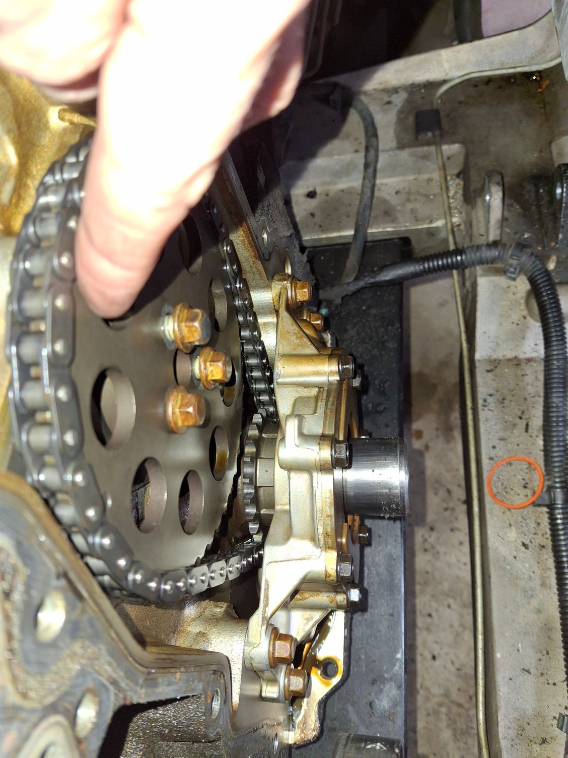

Old post update... I think I found the issue, loose camshaft sprocket. Looking at it from inside the valley cover. I haven't tore the front cover off yet, but it looks like it is loose. Has anyone heard of this?
Yes i've heard of the bolts backing out if blue or red loctite wasn't used. But i dont think thats the same sound.

Just a tip on reinstalling and tightening the cam sprocket; DO NOT use RED Loctite!! Blue will work fine. If you use red, it is considered non-removeable. This is because it will often break off bolts when you try loosening it unless you use heat, a lot of heat! Just the opposite of Franks red hot sauce-I don't use that %#@! on anything!!
Houston, l found the problem...

So not the pin, but the main bolts. At it's an easy one.
Yes, the bolts backed out, pin is good. Putting it back together with a new timing set, oil pump and balancer. Wish I could do a cam and lifters, but that's not in the budget right now.

Good catch!! Use a dab of blue Loctite on them....

I used one of those lock plates
Yep, new ARP bolts and loctite.
