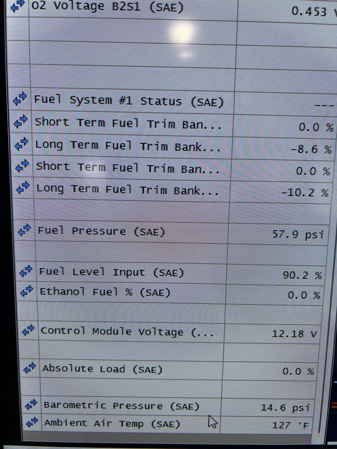

Hi all. My understanding is that the MAF should be reading about the displacement of the engine in grams per second. I'm getting 8.1.
Short term fuel trim bounces a bit between 1% to 3.9%
Long term is pulling out fuel -2.6 to -3.9%
I cleaned the MAF....but same reading......any thoughts?
Car pulls very strong and is smooth on throttle....slight shake at idle. Idles at about 800rpm.
Any help would be appreciated.

I don’t know if you have a stock cam or an aftermarket one with some overlap but it’s going to run a little rough…how much is your manifold vacuum ??…just subtract your BARO from the MAP…say at sea level 29.9 inches Hg minus 10 inches Hg would be 19.9 inHg....a dirty MAF will manifest itself with negative fuel trims at idle going positive under load.

Stock cam as far as I can tell. Although the car is quicker than most other Z06 with similar setups. Manifold pressure is 5.4psi at idle.
Trims are within spec and the idle is not really that rough. I'm going to do a few data logs and read again

To see if you MAP is skewed which may cause fueling issues what is your BARO ???…mine key on engine off is 14.6 psi at sea level or 101 kPa or 29.9 inches Hg…I NEVER use HP Tuners for diagnostics !!…factory level or nothing.
Got it...just broke out my Autel. baro is 14.5.. I'm at 25 ft above sea level. Lt trims now at 1 and -1. Key on, engine off. Was out driving a little spirited.

You don’t look at the fuel trims without the engine running if that’s what you’re saying…just use your HP Tuners for tuning…for any drivability issues I always check that BARO KOEO.

Wasn't looking at tuning now only what was stored. I thought it would reveal where long term were sitting after a good 2 hour drive.
So 14.5psi converts to 29.5 hg
