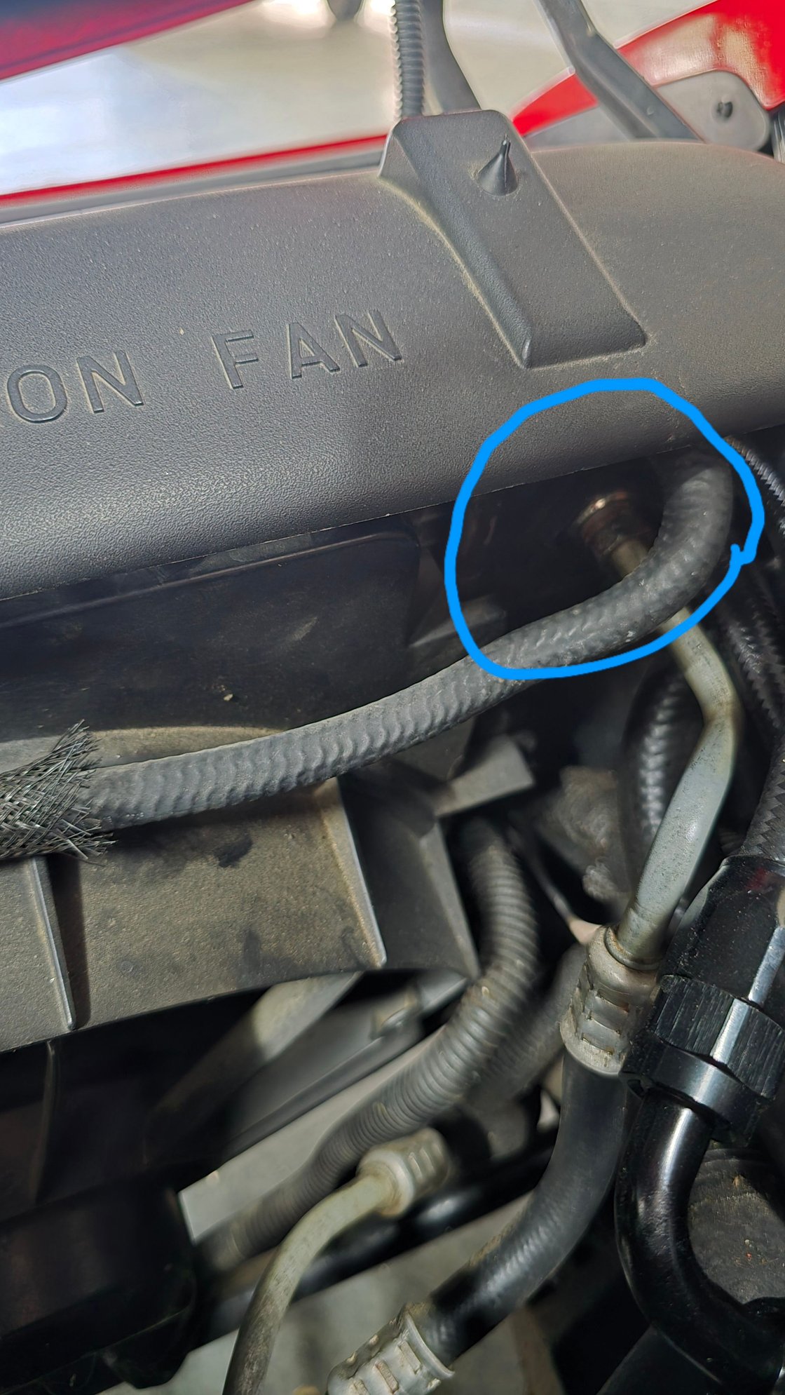

Hi all, im in the process of installing a transcooler that will piggyback off the existing cooler and I've been having problems trying to find accurate information of what the tread is for the top transcooler line that connects to the radiator in my 1998 C5 I know they later changed the thread in 2000 or 2001(?) Any help would be great, photo is the transcooler line im talking about

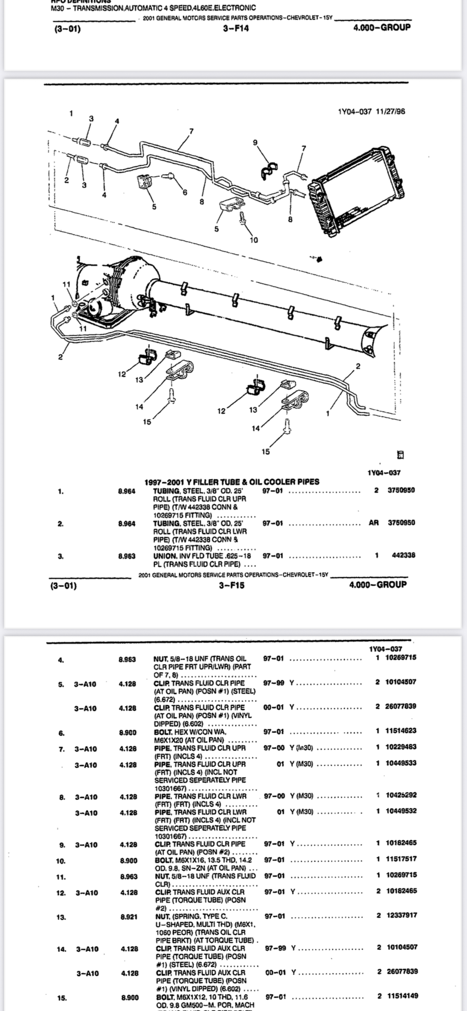

5/8-18

Legend! Ordered some adapters, fingers crossed!
