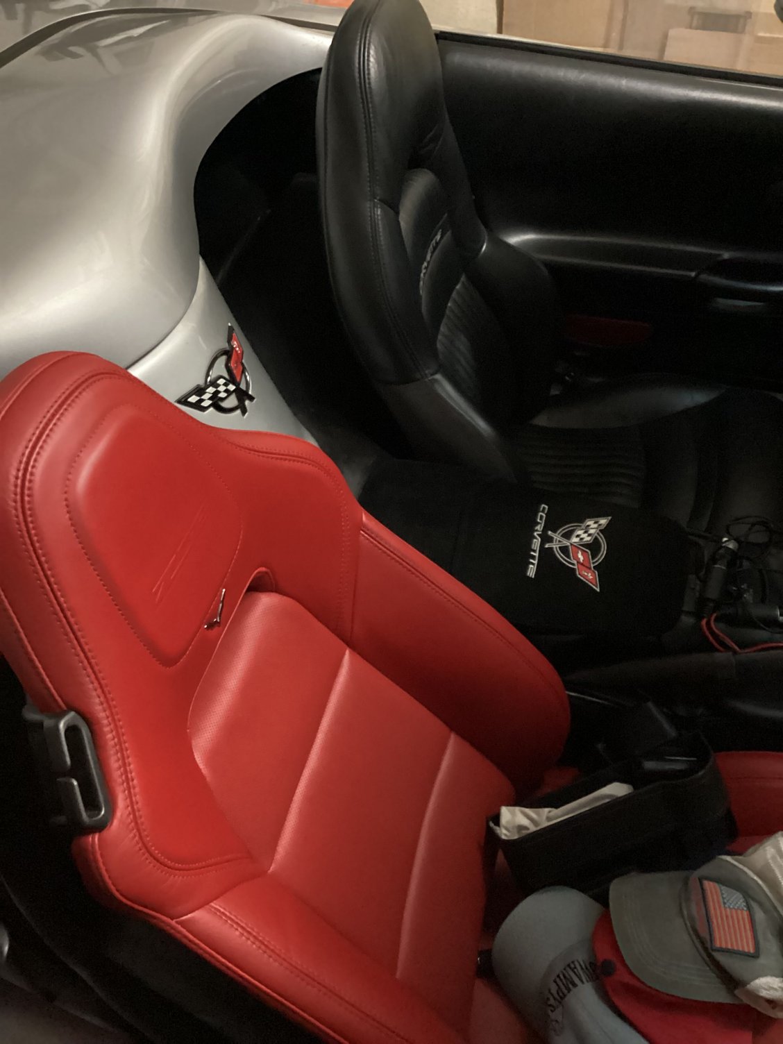

Put in a red 2017 pass. Seat to test fit. Looks good fits nice, but I cannot use my 2 cup buddy
waiting for power harness
used a three inch seatbelt extender shaved plastic to fit C5 side

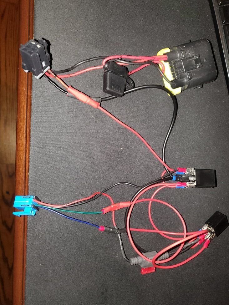

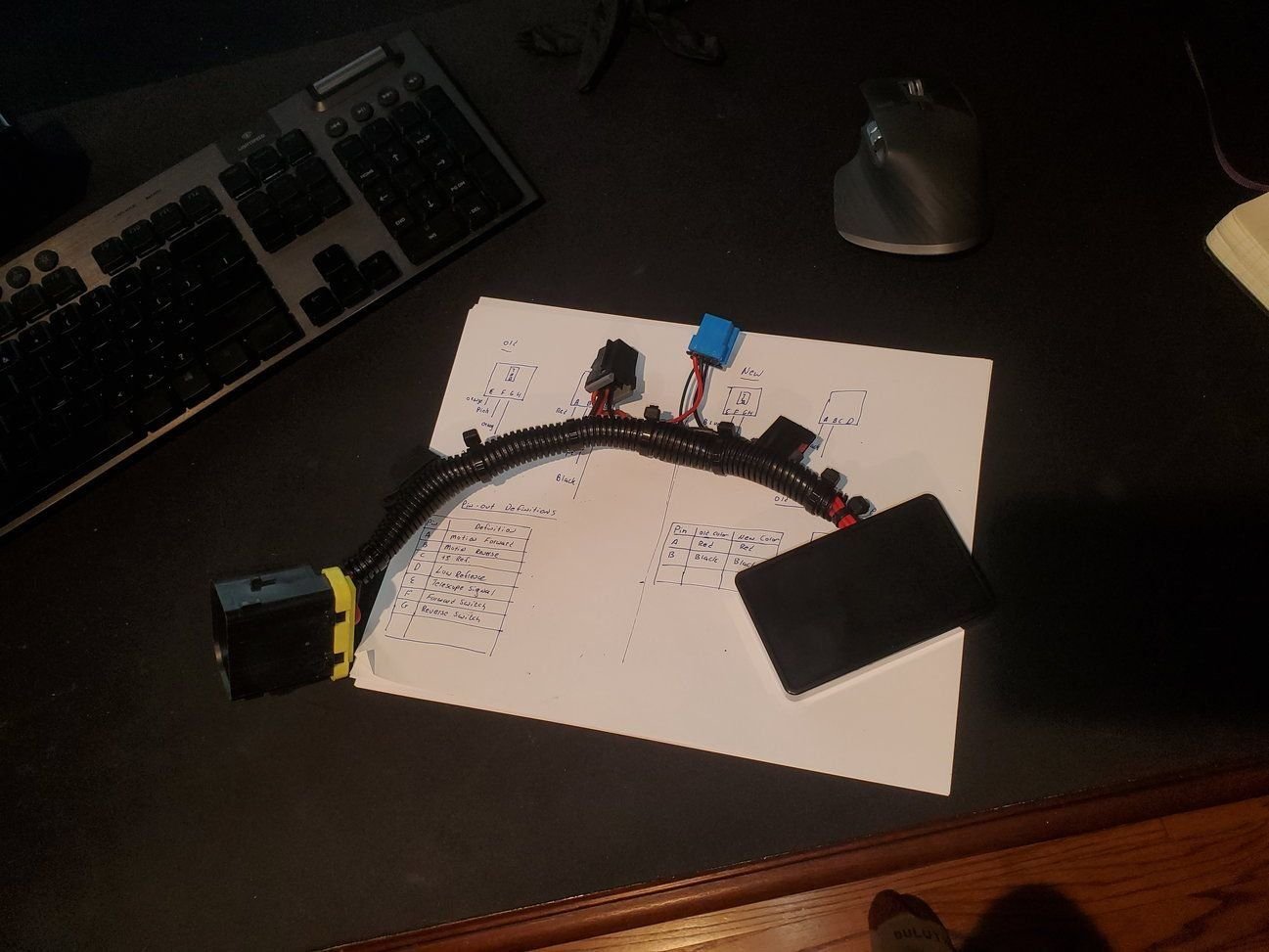

Where'd you get the power harness from? if vetteworks, you're going to be waiting a while. Also, do you have telescoping steering?
On the seatbelts -- best bet is to swap in c6 belts, I posted an instructional video (not mine) in the tech section-- takes about 15 minutes to do.
Here's the harness I did -- IMHO, came out a lot better :

That's one way to go.
I didn't even do that much, just tapped into the seat motor harness and the original seat power harness, then kept the original seat module and harness plugged in to retain column and mirror memory.

In retrospect, I would have done it that way... your way takes about 20 minutes, mine ... longer. For no benefit whatsoever.

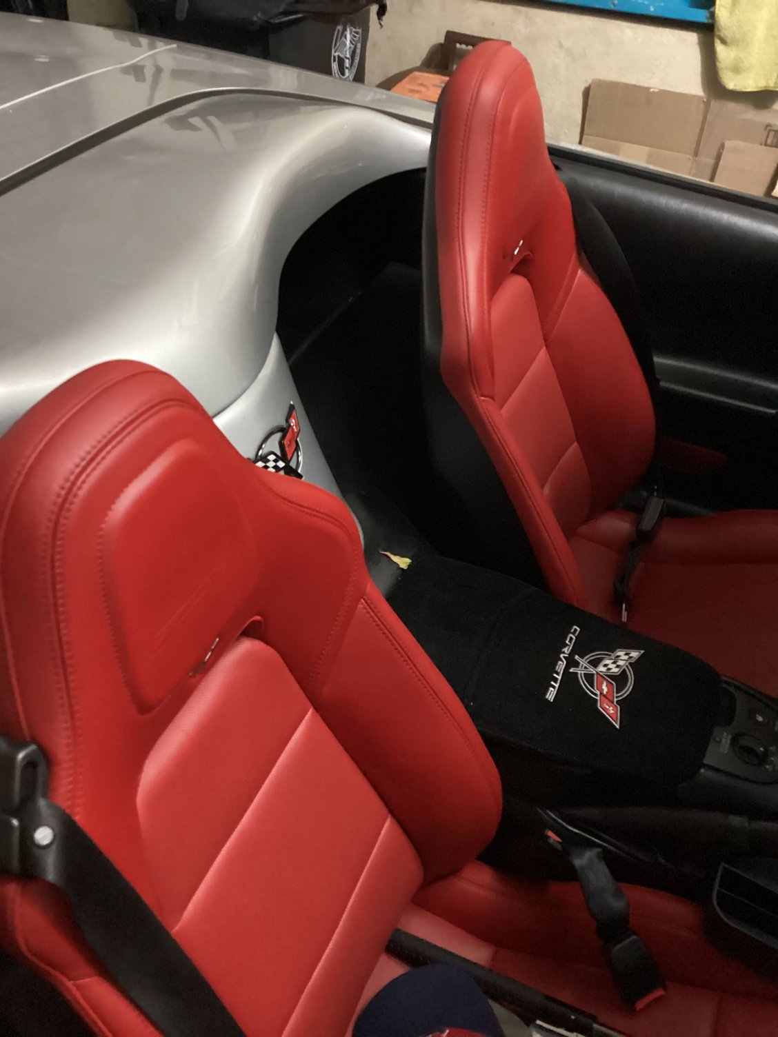

Finish installing C7 seats in my C5. Did temp wiring until harness arrives.

[QUOTE=Ajl#1945;1609077614]Finish installing C7 seats in my C5. Did temp wiring until harness arrives
[img alt="Installed and working only thing I lost was seat memory.
I’ll work fans when I get the vettnuts harness"]https://cimg9.ibsrv.net/gimg/www.corvetteforum.com-vbulletin/2000x1504/img_1561_190a811c02f46171506a067ecb9ad7a 59aa9850a.jpeg[/img]
Installed and working only thing I lost was seat memory. I’ll work fans when I get the vettnuts harness
