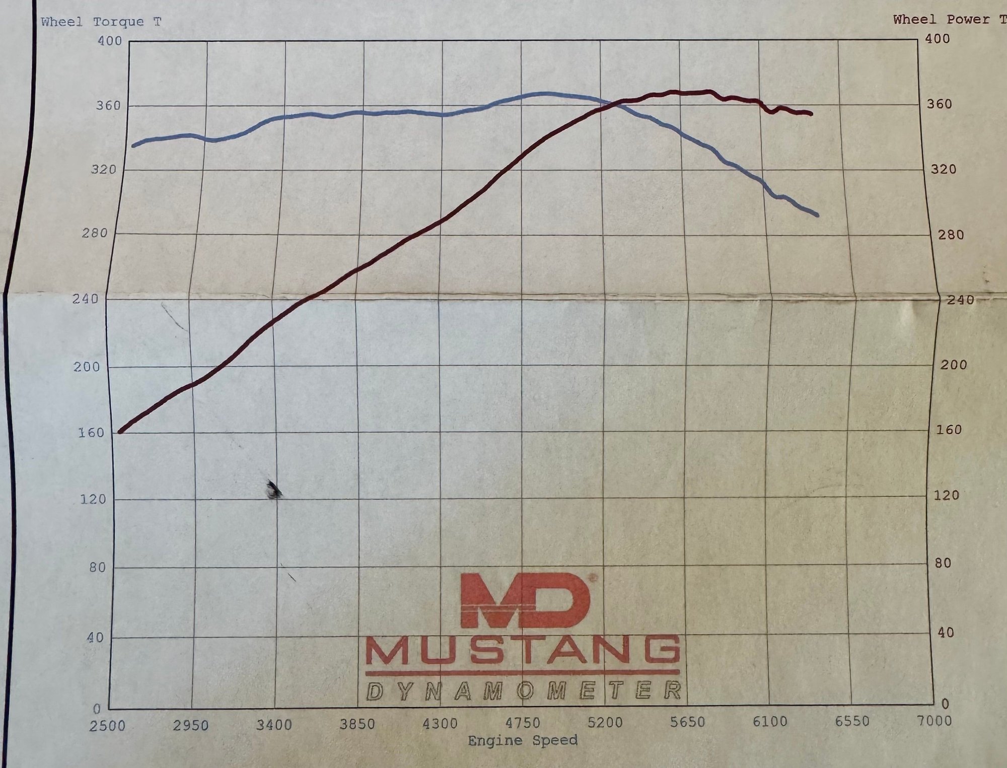

anyone running truck norris cam in their C5? after watching a few videos this cam is a torque monster and sounds great. im gonna give BTR a call before i 100% commit but I plan on running 243 ported heads keeping my stock intake since its the ls6 version and add tpis 90mm snout to it with ls2 TB this should help take care of top end? im in an auto so lets be real im not gonna be hanging out in the higher RPM.

I put one in my 01 this past Spring long with ARH headers and Borla catback. It dyno'd at 370/370 and is definitely fun to drive. Like you I was looking for low end grunt as I rarely wring it out on top anyway. I am super happy with the choice and if I want more, I will add a supercharger to the mix.

370 at the wheels, yes? So about 435 crankshaft. For an LS1 that is a nice bump. Most important for this discussion: where is the torque peak, and how broad is the curve? Any chance you could post the graph?
Old Aug 23, 2025 | 08:26 AM
MikeTD3's Avatar
MikeTD3
7th Gear
Joined: Aug 2019
Posts: 7
Likes: 12

gives me hope!!! im thinking this is the right cam for me as well. thanks for posting a dyno sheet.
