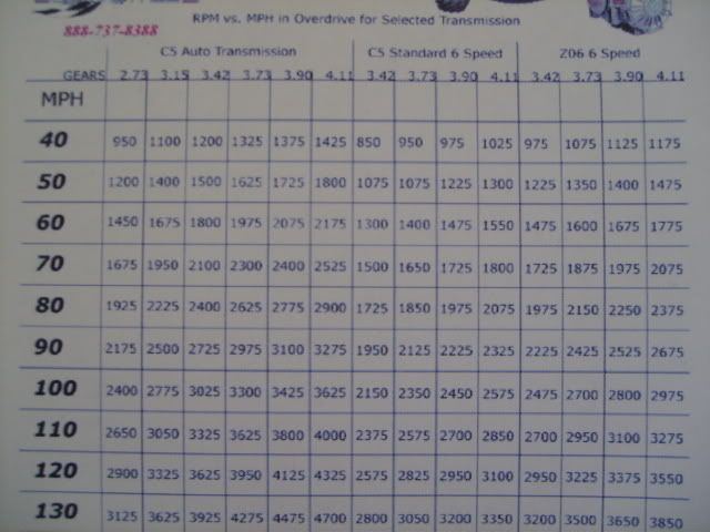

Here's a chart for RPM's at speed
Thank you for sending this over
