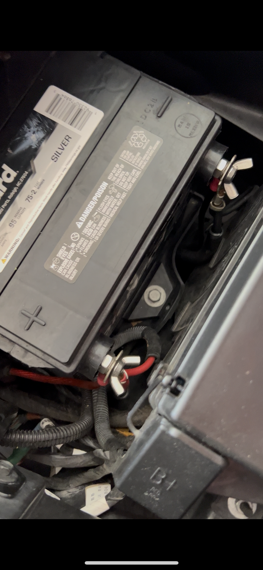

After some reading it does seem like the batteries drain easy/quick. I know for a fact it was running a week ago but it hasn’t been touched or used since then. I’ll definitely take the battery to get looked at but by your knowledge is there any extra stuff I need to take out? I’m unsure on what is connected to the battery here.

Are those wing nuts on the battery terminals? You may just have a bad electrical connection at the battery terminals. I would seriously think about doing away with the wing nuts and replace with bolts as you have to really tighten the cables to the battery terminals, so much so that you can't tighten the wing nuts by hand and achieve the right amount of clamping.
