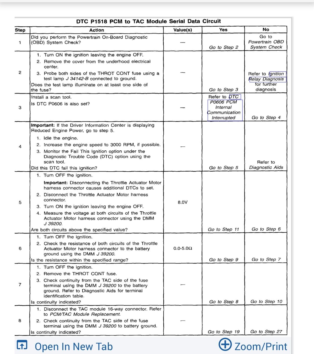

Trouble codes are not part numbers !!…follow the flow chart below and if this testing is over your head seek out an auto electric shop in your area…we can’t diagnose this for you especially since you’ve been trying to fix this for months…BTW, every time you replace a part you do a “repair verification”…each of those parts you changed needs to be tested…never assume they are good especially if you bought them from Amazon or EBay.

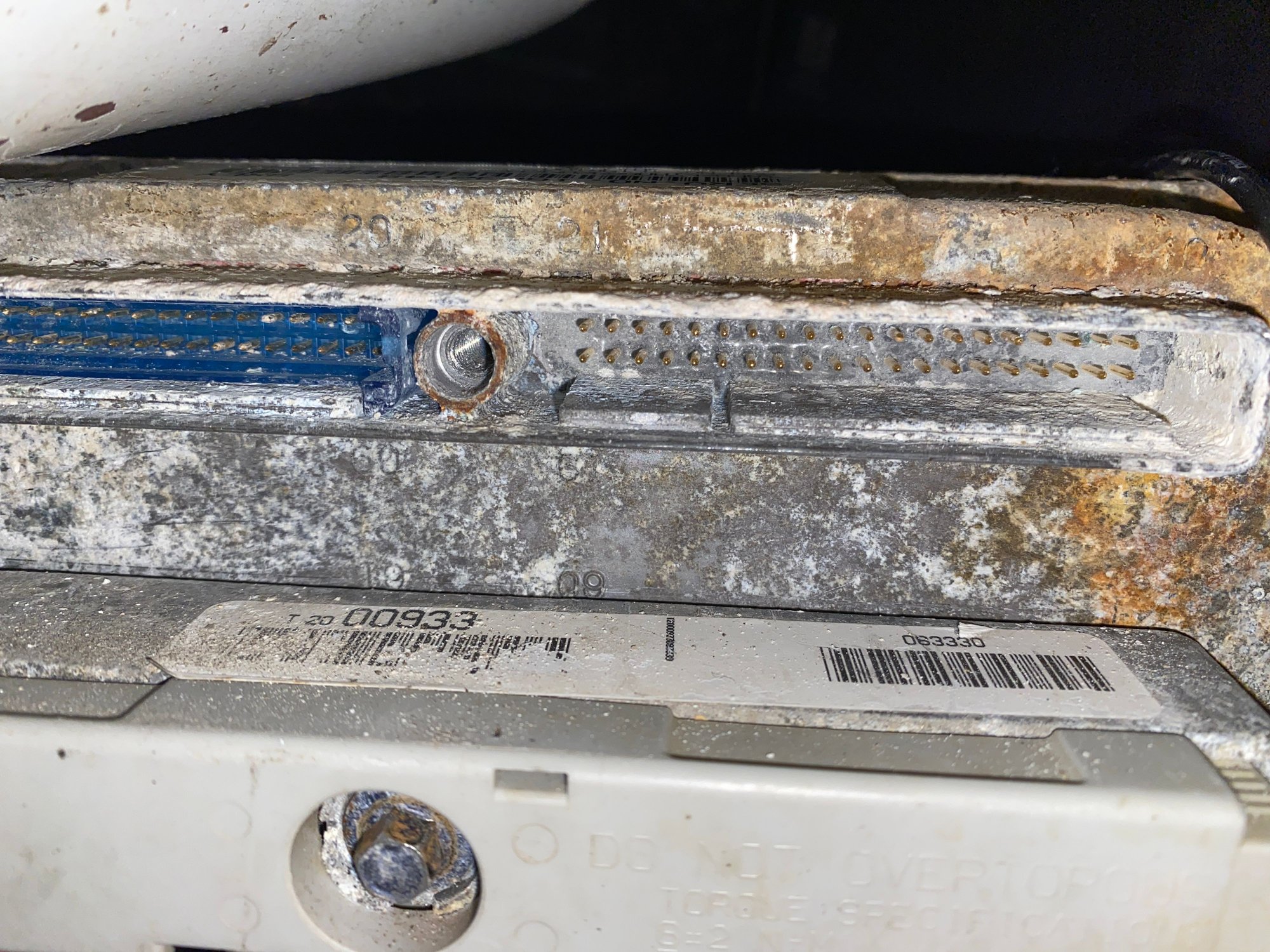

I have 2 TCM’s and they don’t change anything, pcm connectors have lots of white dust corrosion so I’ll see about contact cleaner and dielectric grease for them. I’ll charge battery and see in the morning. Idk what I’ll do if the pcm is dead, seems like for a 97 it’s around 2k for one. The other years are a lot cheaper but idk if they plug and play. Also will find an obd2 scanner and see if it can’t find any accelerator pedal position, (hp tuners could not).
and ideas are super helpful, even if it’s clean the grounds again, I have not got to the ones that are behind the block or under the headers.
pcm connections all look like this

If you do “data driven diagnostics” you would have solved this instead of just guessing…I enclosed the “flow chart” for that DTC…did you use it ??…most of these flow charts are based on using a Tech 2 or factory aftermarket scan tool.

No I did not…so where did your testing lead you ??…wiring issue, bad TAC or bad PCM ??…there are 30 steps in this diagnostic.

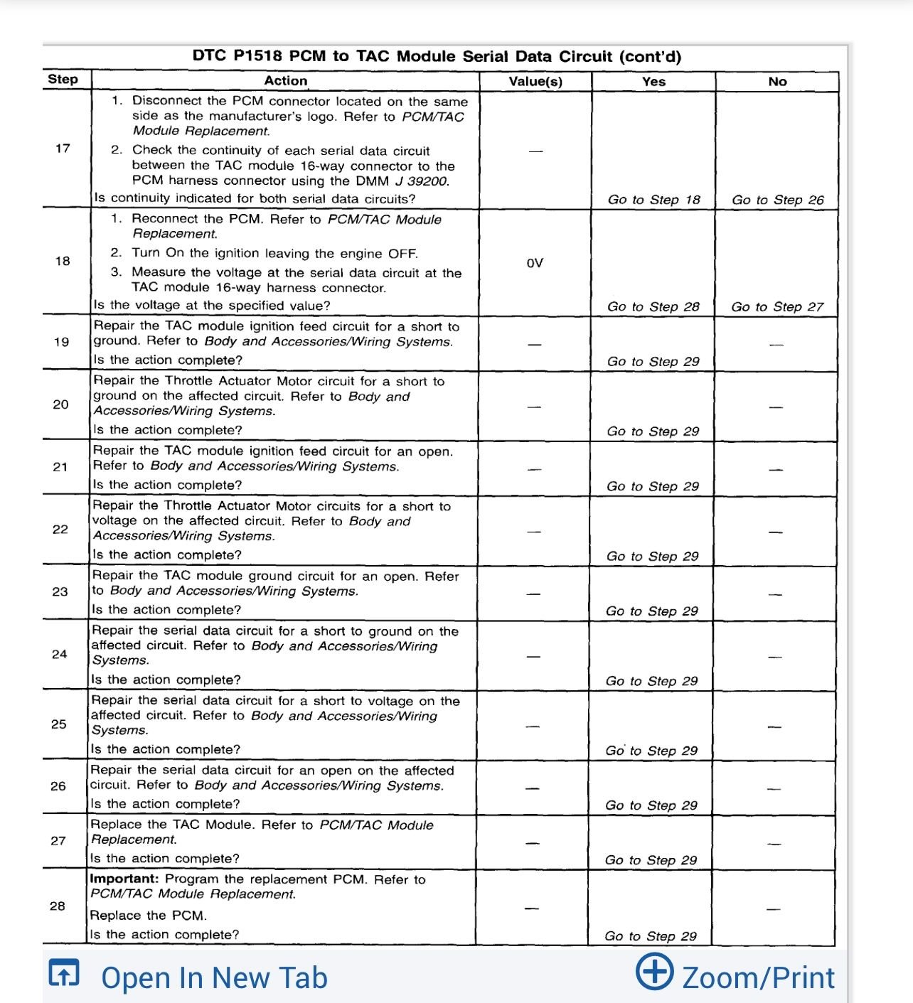

Yeah idk if you can see it, maybe not but I went though every test and get step 27 bad tac module “Replace Tac Module”… ): did I kill one and buy a bad one? Thus my questioning if it’s possible to test outside of car.
