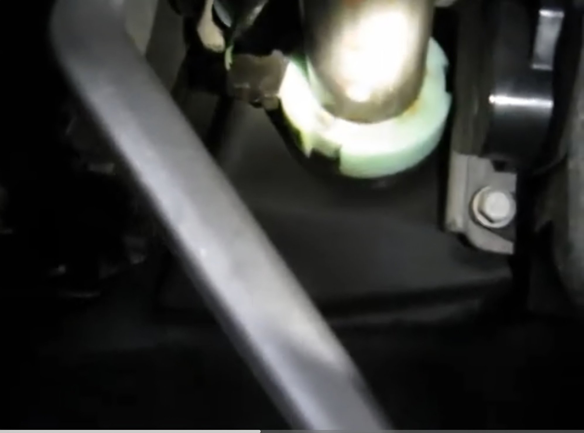

I’m attaching a picture of what I think it is.
Could you please tell me exactly what part this is and how it can be repaired? Or is it possible to buy a completely new one?
corvette c5 , 2001
Thanks!

Get a vid of the noise. Can't really tell by the pic

Was there any recent performance work done on the car where they had to move or re-install the steering rack or steering shaft? Sometimes the groan or squeak is a result of the the steering rack being reinstalled and usually a blast of lubricant way up underneath the steering column near the firewall and through the front engine bay is enough to remedy the situation.

No, nothing has been done with the car. I tried spraying it there, but it didn’t help.
