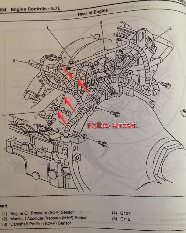

I had a similar issue. I had the whole interior and dash apart for a sound / heat insulation project.
The rattle in my case came from a loose harness bracket that is bolted to the back of the passenger side cylinder head.
The diagram below is to help illustrate harness attachment points.
