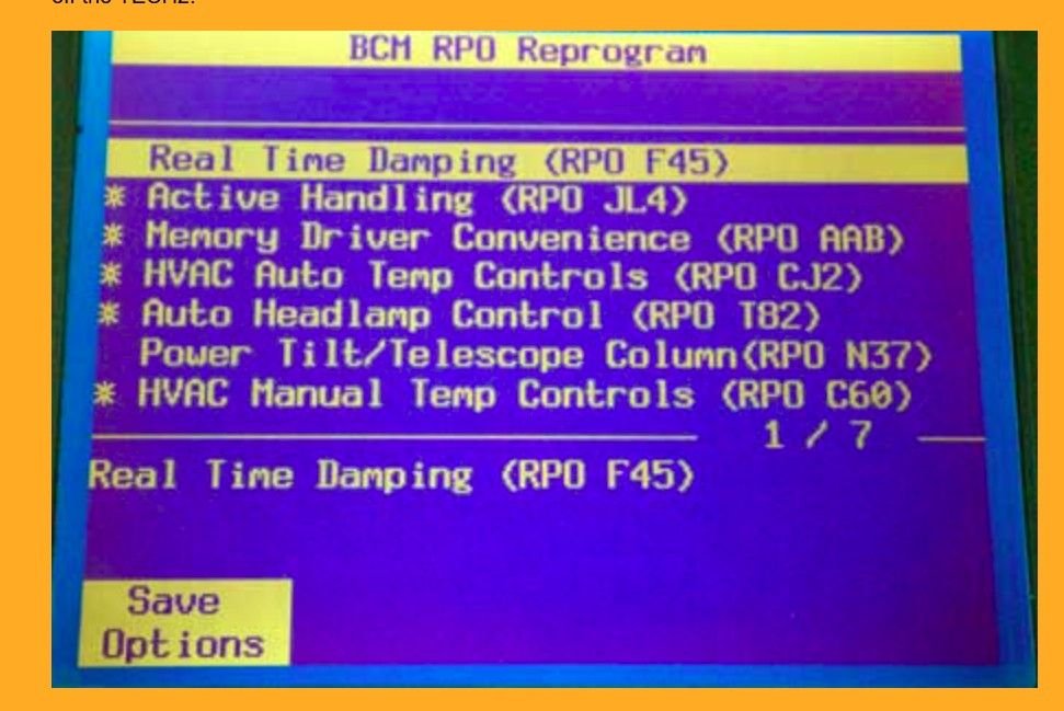

So the screen on your Tech2 does not look like this?
Hi,
yes it looks like this but I dont remember if there was F45 or F55. I don't know what is the difference between those 2 (F45 / F55)
