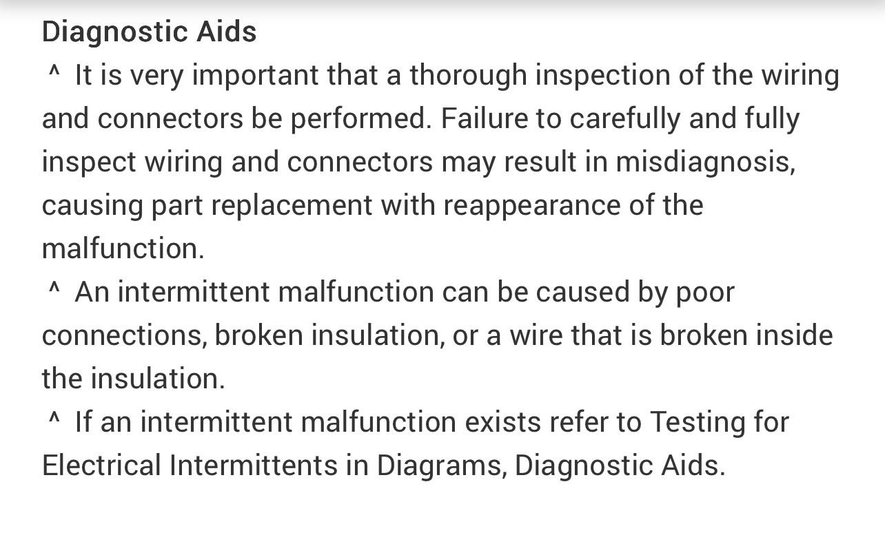

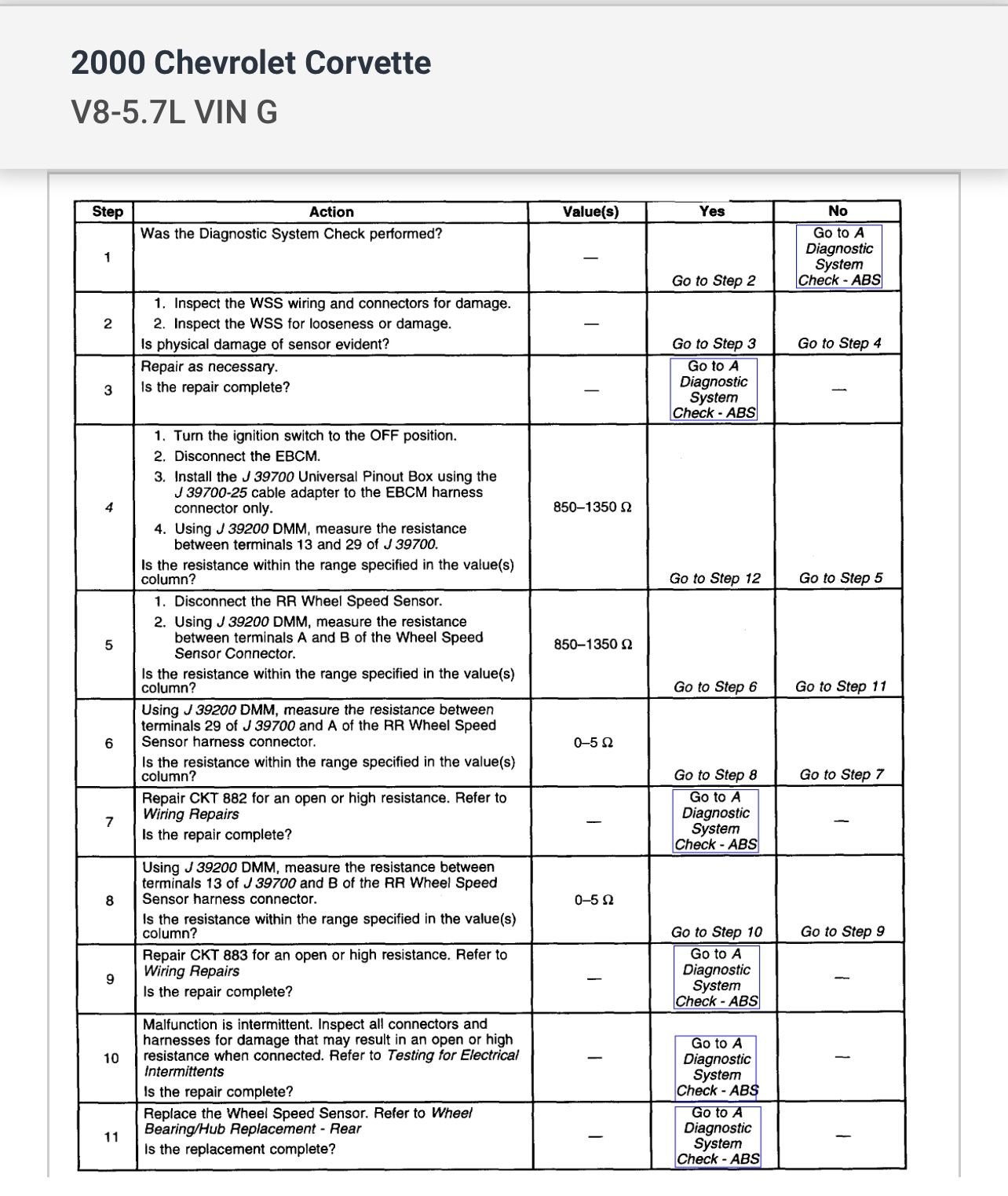

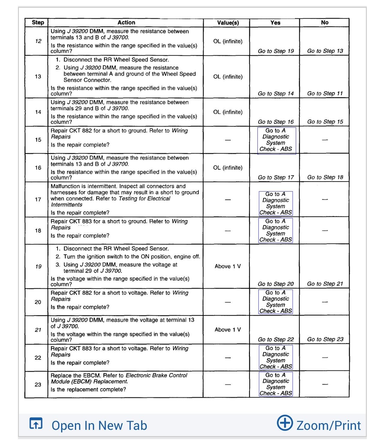

You need to check with DVM. Wires can look good but the contacts is where most of the problems are. Just went through this. Check omhs across to prongs in connector and voltage should be around then check voltage but rising tire and turn wheel. You shough see voltage (forgot what range) and i belive its A/C at the sensor connector. Must disconnect and just check the sensor side. If that all checks out you have a wire issue to the EBCM
Volts .5 to 1V 1000 to 2500omhs

You can’t diagnose this by “looks to be OK”…if the flowchart testing is over your head seek an automotive electrical specialist…we can’t diagnose it for you.

Thanks, now we have some direction on what to do and look for.
