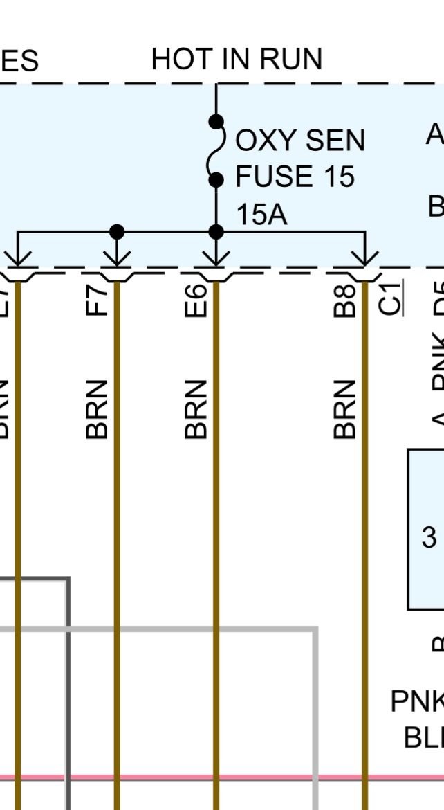

Old Oct 7, 2025 | 01:10 PM
MSOH's Avatar
MSOH
Veteran: National Guard
Joined: Dec 2022
Posts: 273
Likes: 142
From: North Central Ohio
And that would be fuse 15 in the engine compartment fuse block?
Old Oct 7, 2025 | 01:21 PM
C5 Diag's Avatar
C5 Diag
Moderator, Tech Contributor
Posts: 15,594
Likes: 4,055
From: Cape Coral, Florida
Yes !!…if you don’t remove it the sensor will not remain at 450mv’s when testing.
