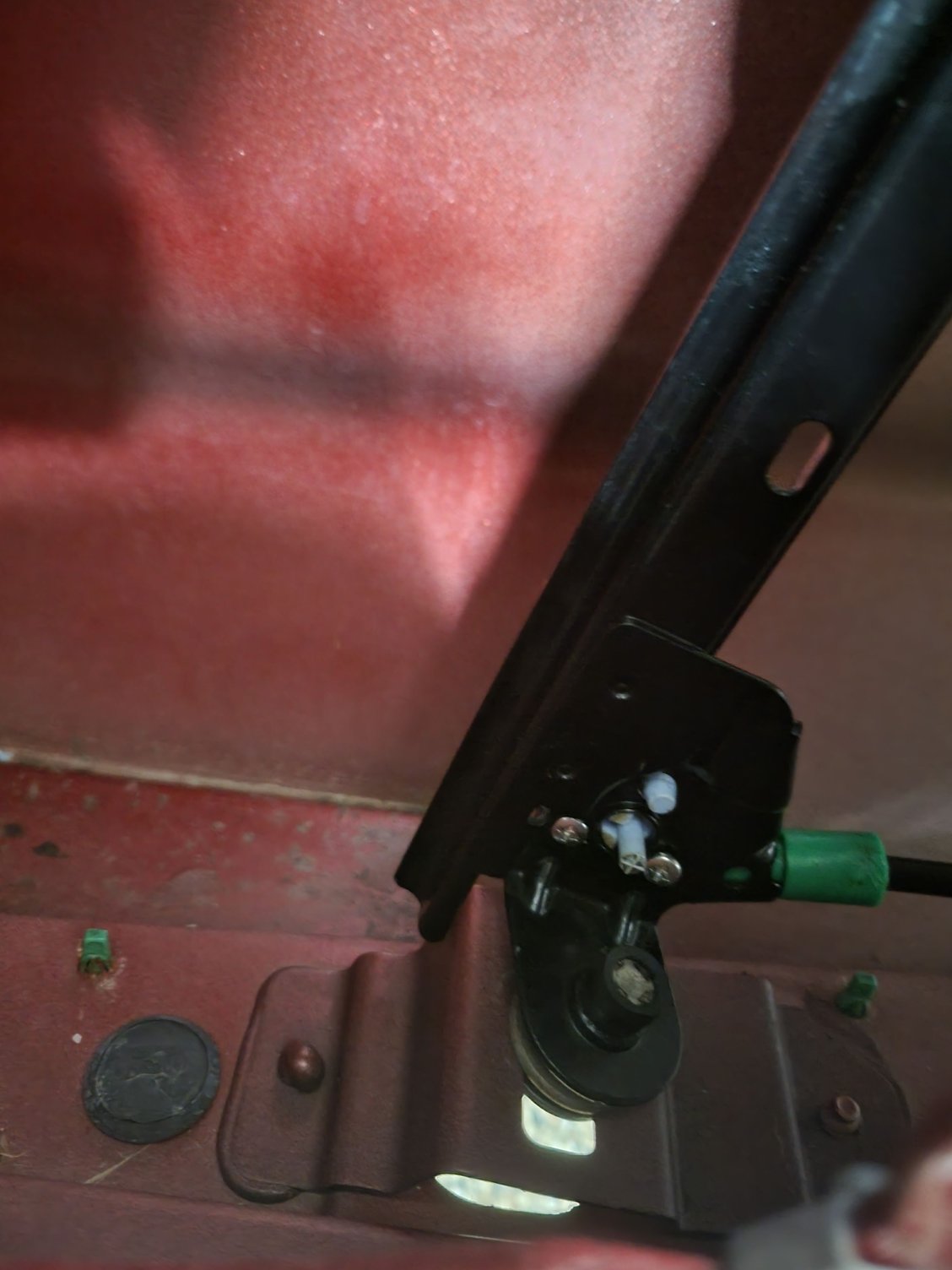

Here's how I fixed my regulator.
The small half pulley on the bottom of the forward window channel snapped off.
I refastend it by drilling 2 holes where the plastic pegs snapped off and used self tapping screws to reattach it to the channel.
[img alt="Pulley repair
"]https://cimg8.ibsrv.net/gimg/www.corvetteforum.com-vbulletin/2000x1504/window_c7d3af59f6bc85792796e844a8e74be24 9a02ed9.jpg[/img]
Pulley repair
