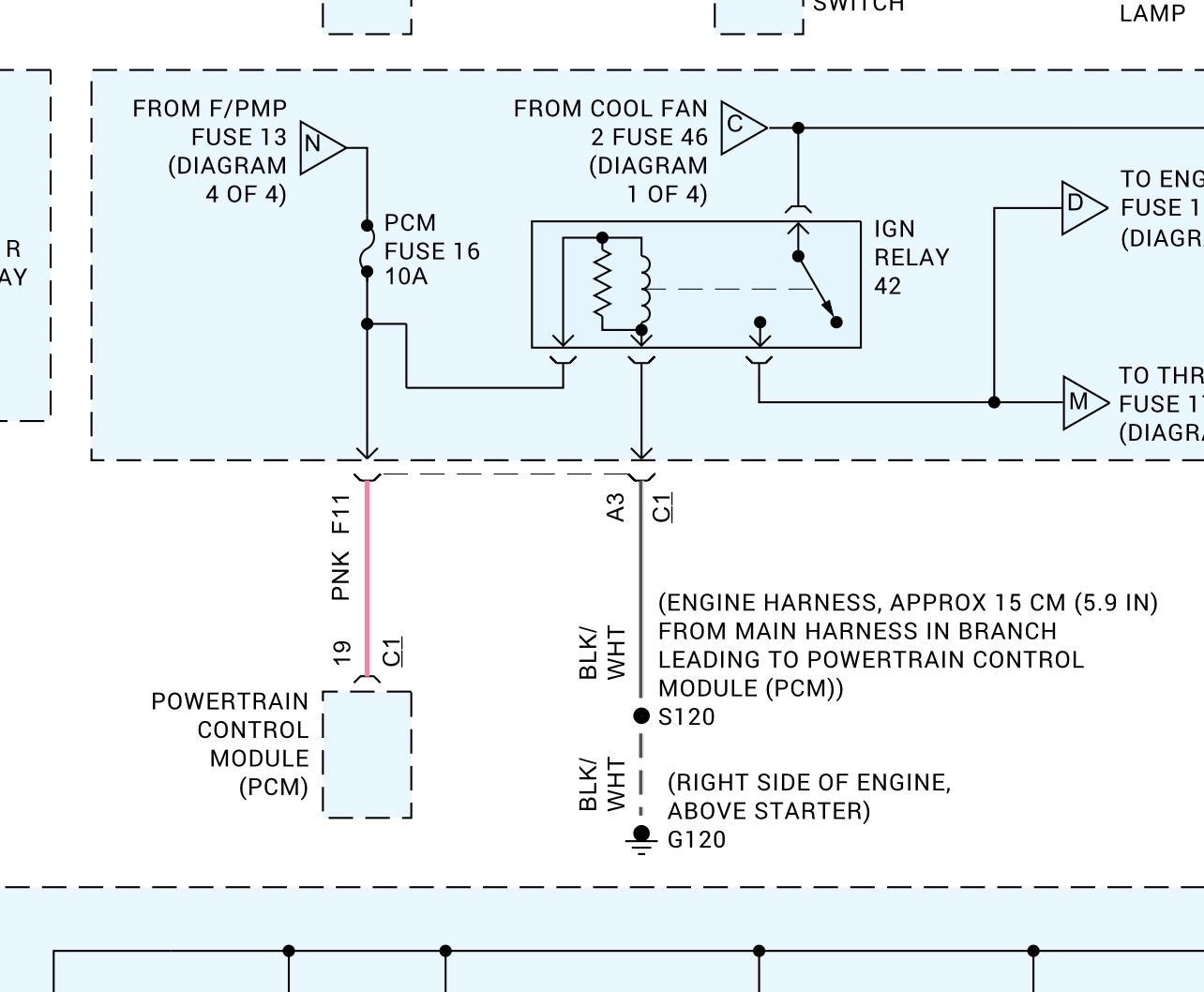

You should probably check for pin fitment in the fusebox if your concern cleared up after removing and reinstalling the relay…I’d also do a voltage drop from battery positive to PCM Fuse 16 since it is the coil side feed to the ignition relay after the fuse…you need to try to crank the engine over to perform a voltage drop check.

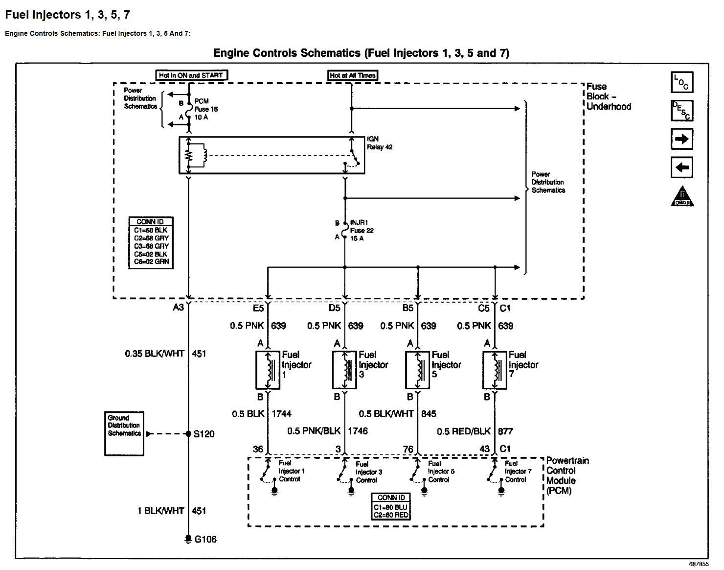

I also recommend to verify the continuity between the IGN relay 42 and ground G106 including the splicepoint S120.
Any bad connection on the negative side of relay 42 could problems
