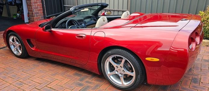

My Stock 98 from Arizona with 80K miles on it.
