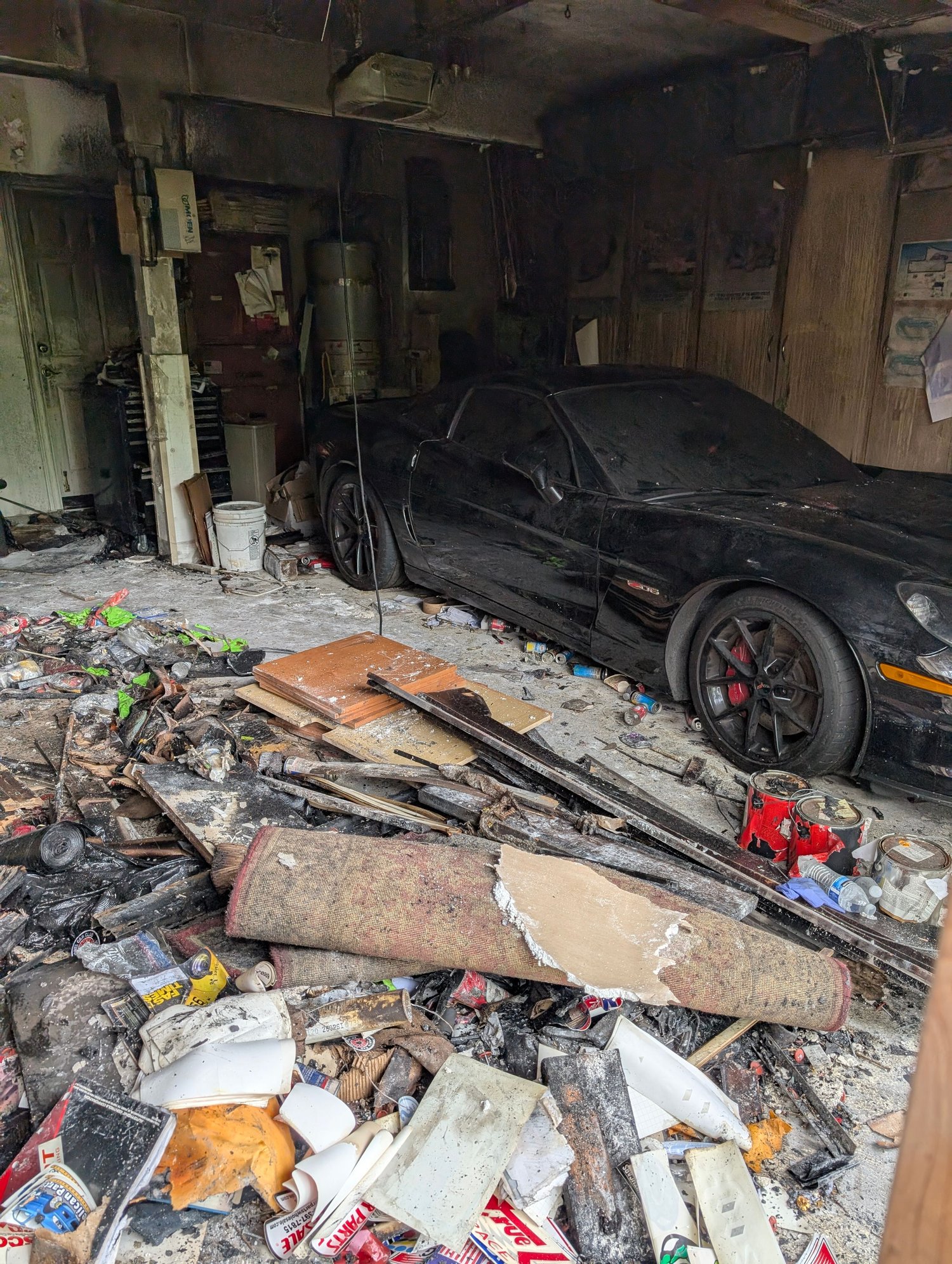

Thanks all, good info. The needle gauge did peg and bright red engine overheating showed on dash. This in 5 miles of local slow stop n go. Under the hood no sign of leaks. I will inspect further soon, crazy busy with other stuff. Need a new ir gauge mine got toasted in the garage fire. Along with most other tools, Ugh. NOT THIS VETTE THE 2004 is overheating, this one gone.
Li-ion battery on power tool exploded

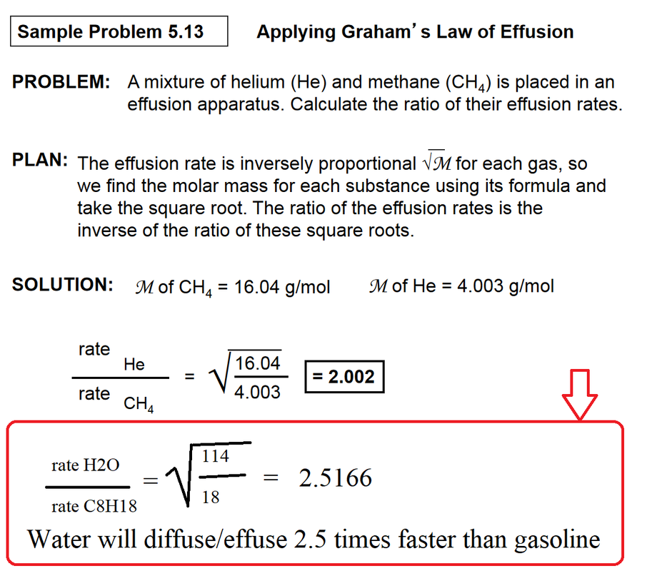

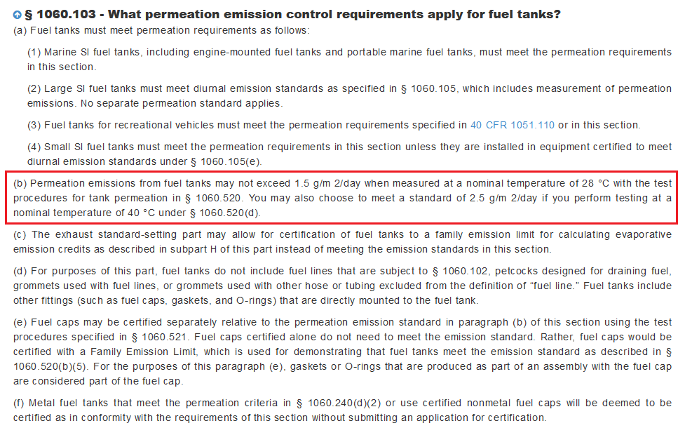

We can extend this to gasoline in the presence of water, to illustrate another practical point about fuel systems - that is
Fick's law, concerning effusion
There is always some rate of permeation, and effusion, of fuel and water that goes right through the fuel tank's walls. Just like water will undoubtedly effuse right through the hoses and probably even the aluminum fixtures of an engine
We have to be careful when a cooling system is left alone for long periods, because of general losses, evaporation, effusion, permeation, and keep in mind the coolant overflow tank is exposed to the atmosphere which means it is constantly acting as an evaporative emission e.g. water pushed into the coolant over flow tank is constantly being lost to the atmosphere based on the surface area and access to the little vent at the top.
