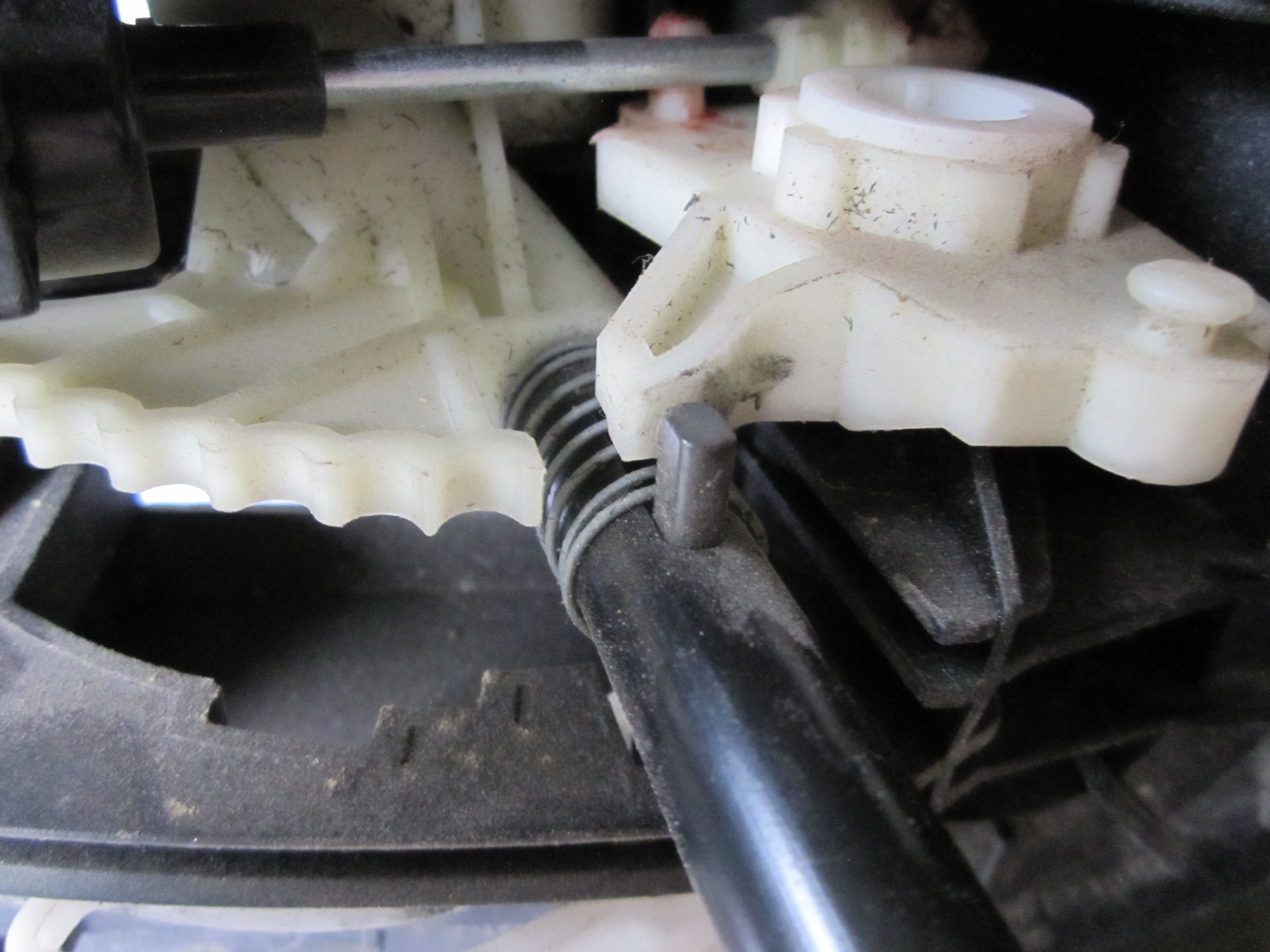

Is the **** loose where it has lifted from the shaft some or the inside of the button worn? I would check that area first as the internal shifter parts don't wear much.
Here's what the button is moving, when the spring loaded pin is pushed down it moves the nylon assembly in this case out of park. This contact area under the pin would be where excessive wear could require more button travel.
Here's a another picture showing where the pin is in relation to the shifter shaft.

That the pin has worn down the plastic. Nothing is loose. How do I get to the bottom of the shifter? Pull the console again?

Yes, the console needs to out to remove the shifter and don't lift the shifter too much when you disconnect the shift cable or the plastic cable will break.
