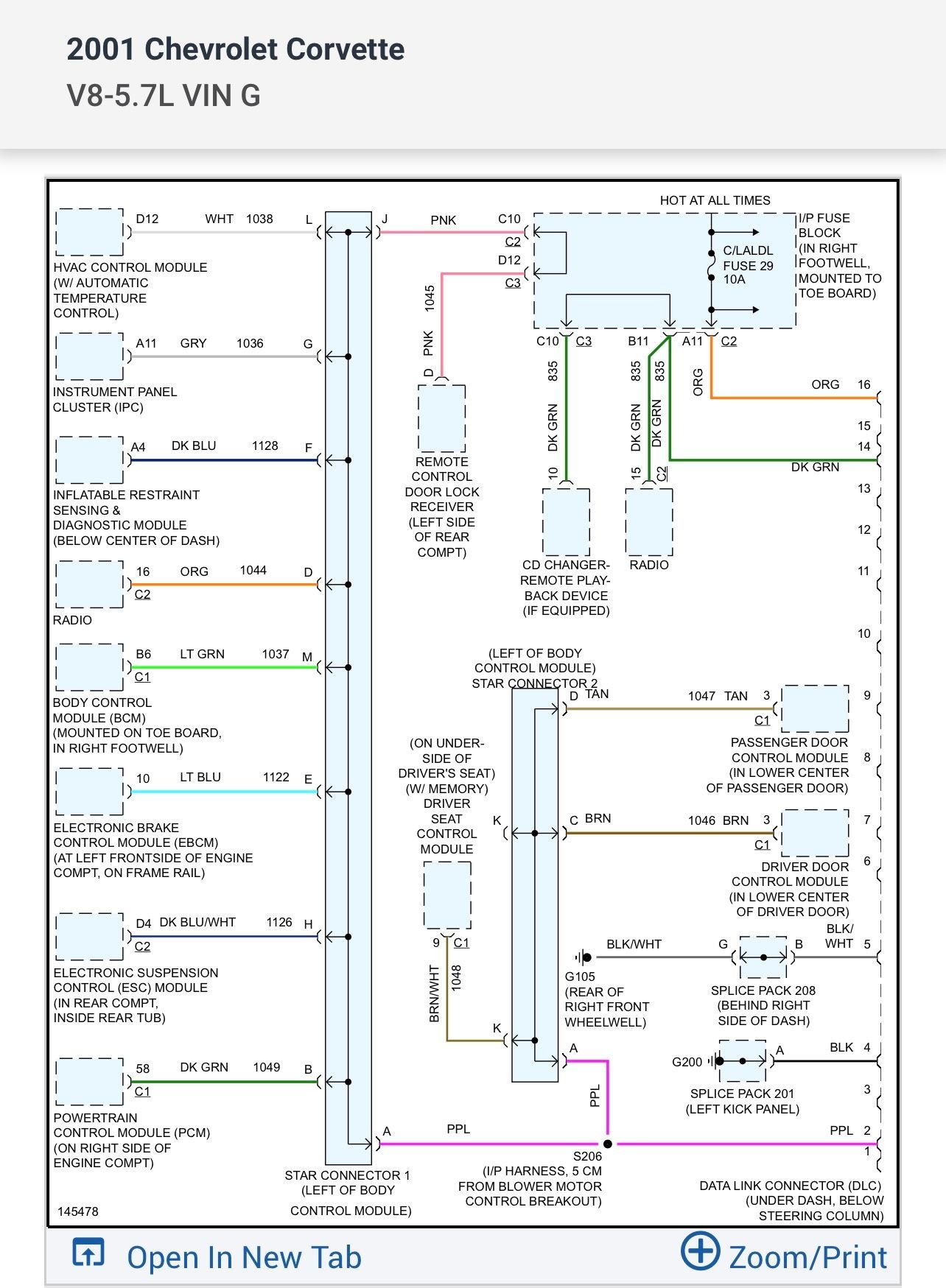

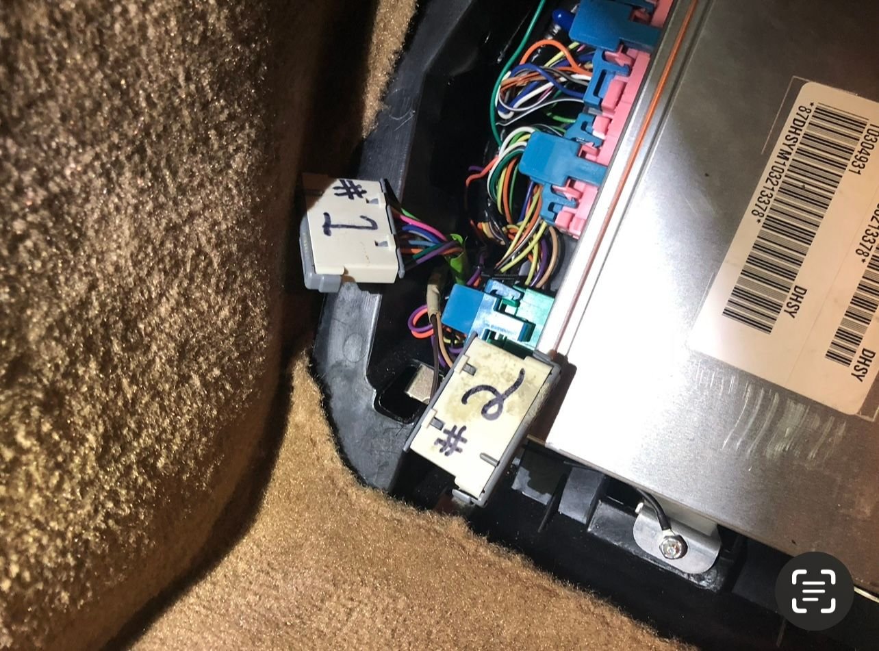

C5’s don’t have the “CAN bus” but the older GM Class 2 Serial Data Bus so whoever told you that doesn’t know what they are talking about…for ANY module “no comm” you first want to check that modules power and grounds and in the case of a 2001 there are 2 power (battery and ignition feed) and 2 grounds…best to check with a bulb that carries a few amps…the serial data wire is light blue and I would check that the light blue wire has continuity between the EBCM (Terminal 21) and Star Connector 2…also remove the buss bar from Star Connector 2 and make sure the “comb” (buss bar) is clean…you can use sandpaper and reinstall…if powers, grounds, and data bus are good the module is bad…also check the connector for pin fitment…if there are loose connections you will have issues…what do you mean by chassis grounds were “refreshed” ??…if you mean cleaning and the ground wire were broken all the cleaning in the world won’t fix it !!

Have battery voltage between Battery / ignition feed (ignition voltage 3), and both grounds on connector.
Will check blue wire between EBCM T21 and Star connector 2.
Thank you!

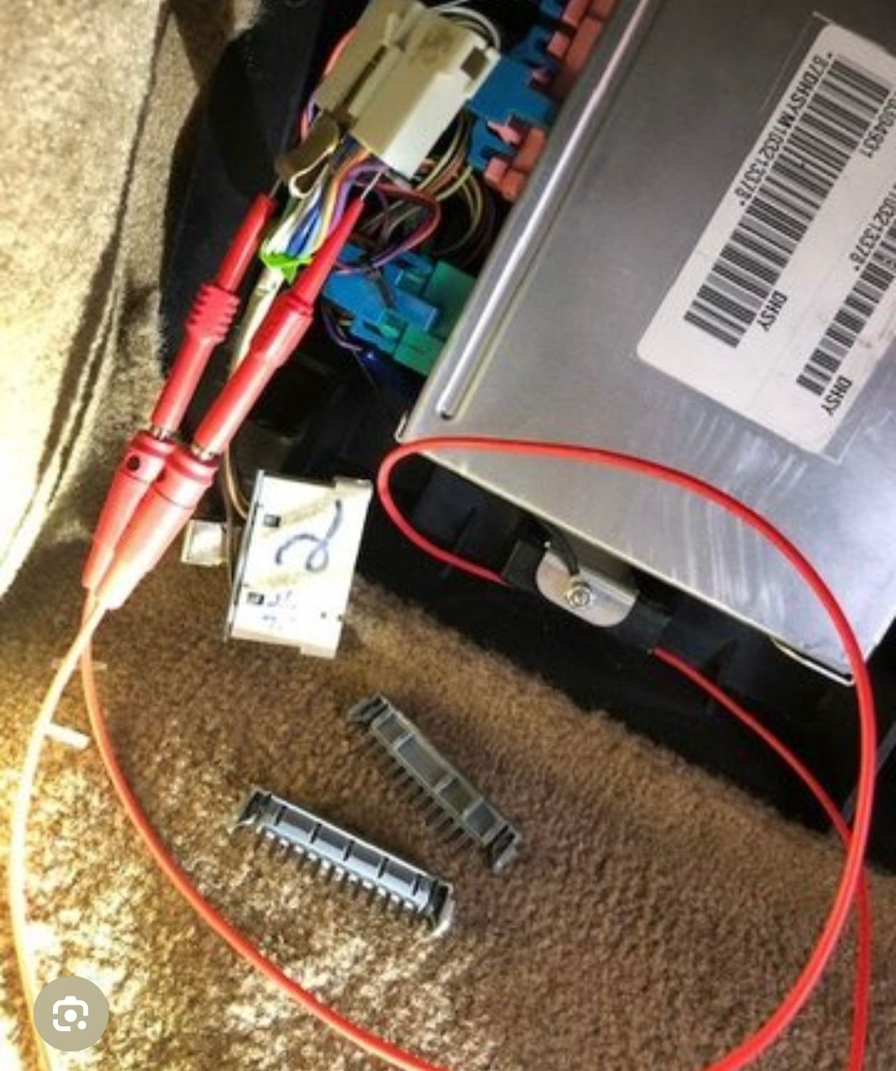

Cleaning a ground is not checking it…you need to connect a bulb that draws a few amps and connect one lead to B+ and the other lead to each ground…if the ground is good the bulb will be bright…do the same with both power leads…just because you have “voltage” at both power feeds doesn’t tell you anything…has to carry current.

Similar to what I am doing here in my car on the G108 ground

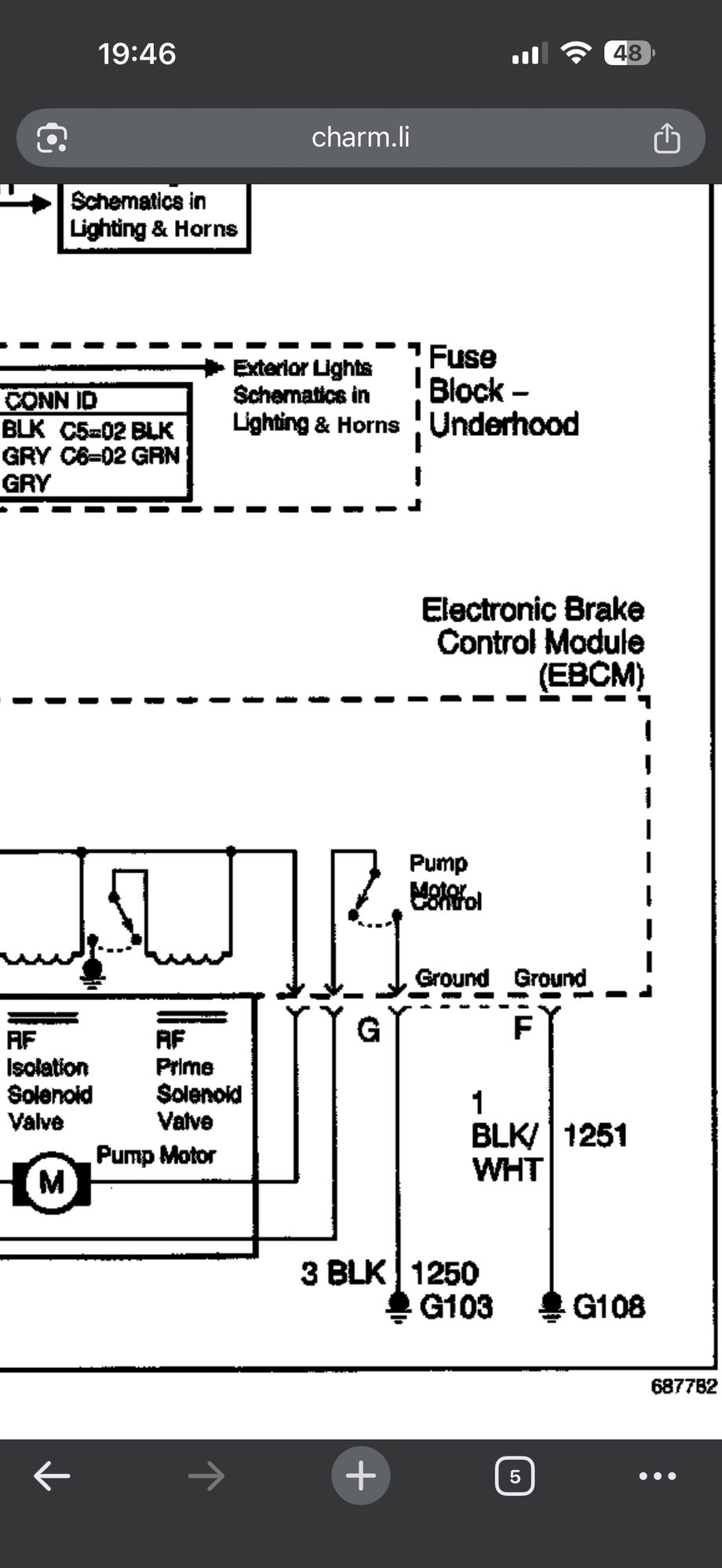

From: Southern Norway , Europe
Default Very good
The correct grund number is G103 and G108

Likes: 10
From: Stockholm, Sweden
Alright, C5diags paper showed G111 but I think you are correct.
Black/white wire to under battery tray was broken, and I guess that's G108
