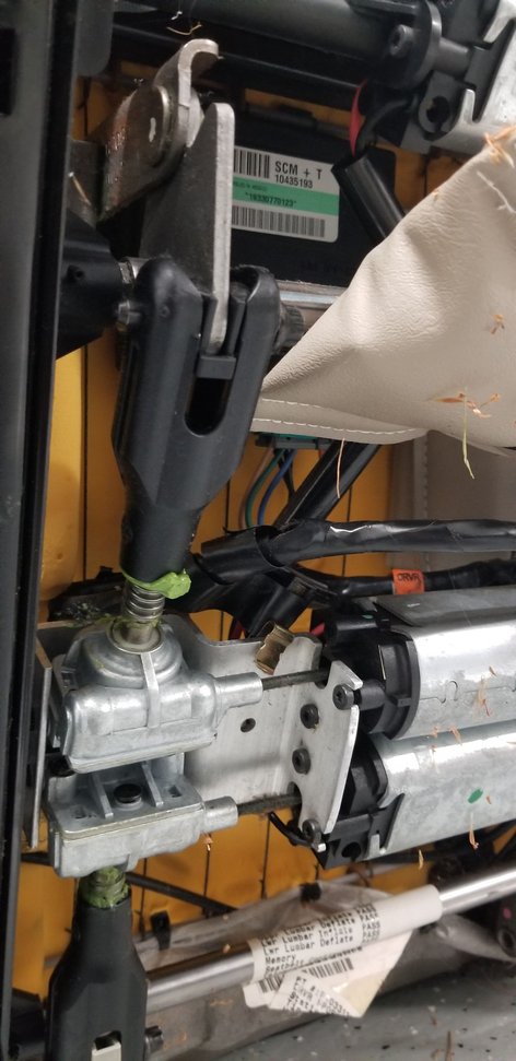

The lift mechanism underneath looks like this (with the seat in the lowered position).
The worm drive pushes the clevis and turns the cross shaft to lift the front of the seat; (same at back).
Hopefully your issue presents itself readily. Good luck.

What Rich said, but add to it that the clevis is plastic and broken. C&S Corvette has billet aluminum replacements — and I seem to recall someone makes steel ones as well. They are not free by any means, so you might want to verify before ordering.
Vettenuts has a good photo of the base:
Plastic clevises on far side of photo.

I will pull it and see if I can see what is bound up, I doubt it is the clevis because if that was broken I would think the motor would still turn and just not move. Honestly if I can disconnect it and get it down all the way that is fine too.
