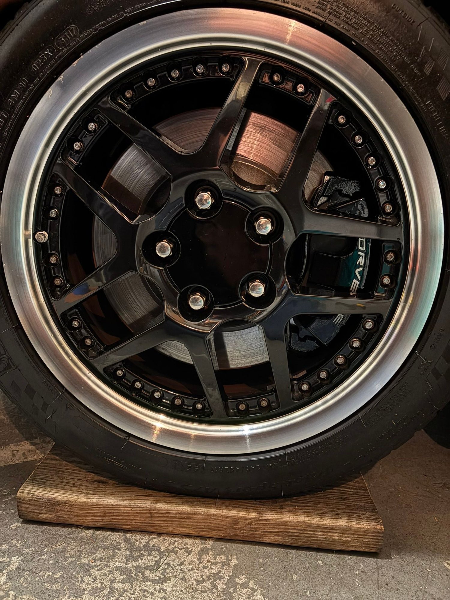

Originally Posted by dfederici7@yahoo.com
My car is silver with black and silver wheels so I kept with the same theme and painted the calipers black and sanded the raised lettering.
O.K., clearly you already have enough on your plate, but my ‘99 is silver, and I contemplate gloss black and polished lettering, so — when you have the time! — a couple of photos would be awesome!
Old Nov 20, 2025 | 08:40 AM
CorvetteC51998's Avatar
CorvetteC51998
Cruising
Joined: Oct 2025
Posts: 12
No Problem. Something I learned to make it easier, after you have everything taped off rum chapstick lightly on the letters before painting the calipers. Once the paint dries you can simply rub the paint off of the letters.
