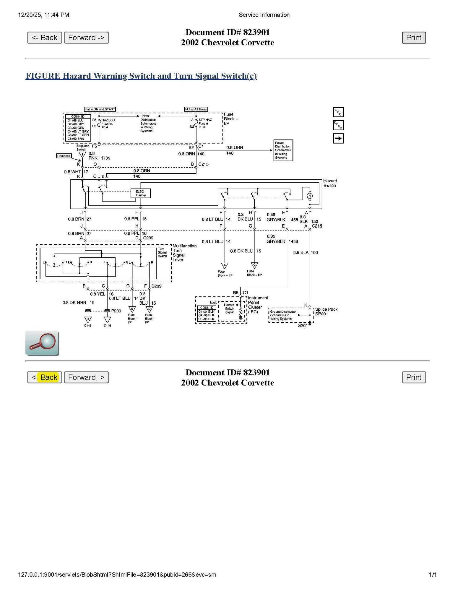

So what do you know?:
-The ground to the lights sockets is good, because the tail and turn signals work
-The wiring to from the MFS to the light sockets (dark green wire) is good, because the turn signals work, and the stop lamps use the same wire.
So the question is.....do you have 12v at contact K (white wire) to the hazard switch connector with the brake pedal depressed? If no 12v, then you have an issue between the hazard switch and the brake pedal switch. If you do have 12v, then your next check is at C209, and check for 12v at contact A. .....or..you can start at C209 contact A, and work your way backwards. PITA?...yes. but very simple troubleshooting.

I did some troubleshooting on my vette today. I’m indeed getting 12 volts on the white wire feeding the hazard light switch, only when brake pedal is applied though. I’m unsure where to go from here. What are those other points you referenced with a C?

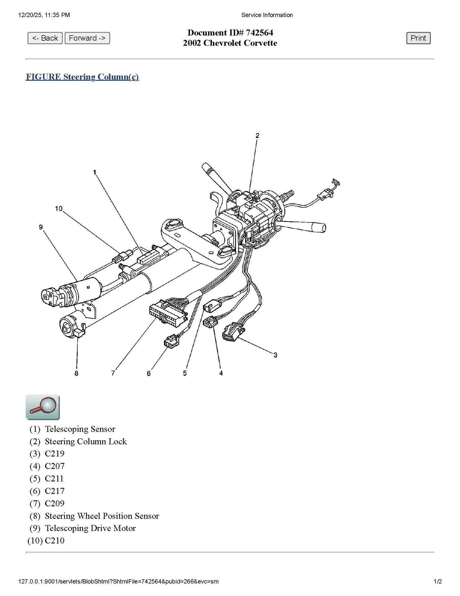

Where is C209 exactly at?

Once you find C209, you can check everything else.
Harness side - contact A (brown wire) - Should have 12v with the brake pedal depressed
You can also read through the MFS on the plug side, etc.

Well looks like I’m not getting any power on C209 when the brake pedal is applied. I’m trying to wrap my head around all this, I’m good with anything mechanical but I struggle with the electrical stuff. So power leaves the brake pedal switch when brakes applied, goes to the hazard flasher switch, then goes to the multi function switch, then goes out to the rear brake lights. It appears I possibly have a bad multi function switch if I’m reading the prints right.

So with the flasher plugged in and the brake pedal depressed, you are not getting 12v to contact "A" (brown wire) ...checking at the C209 harness side (not plug MFS side)? Perhaps you can post a pic of your setup?
