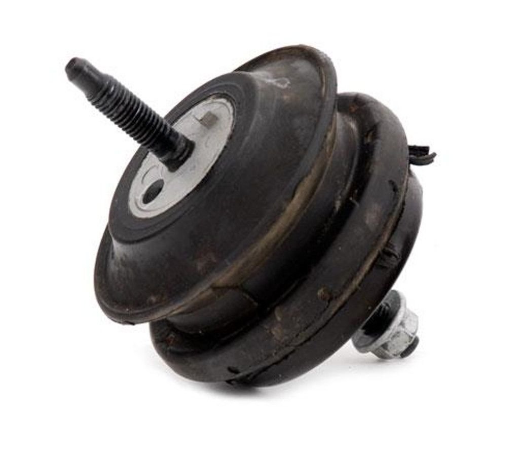

OEM: Basically two studs with an oil filled bladder in the middle. Great for absorbing vibrations, not very durable or consistent over time.

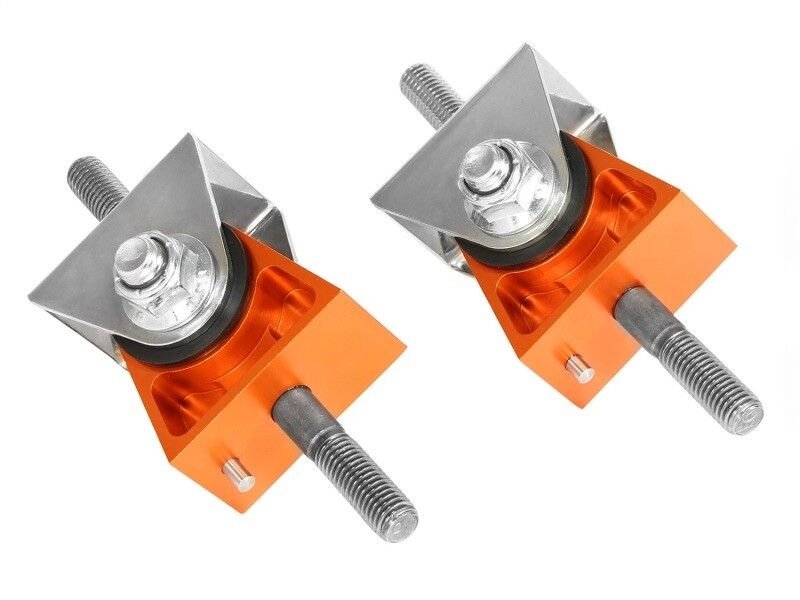

The AFE Style thru-bolt mount
Two piece system with saddles and a thru-bolt, sorta like a sway bar link.

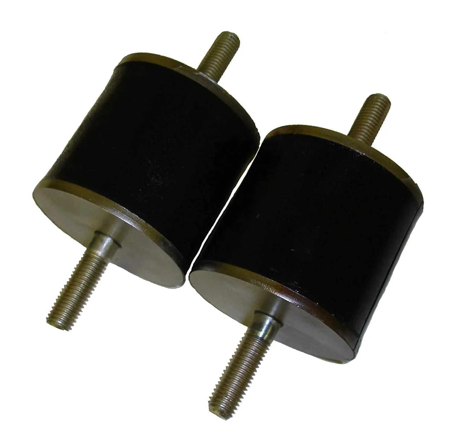

The AMT/Hinson design
A bushing captured between two "cups".

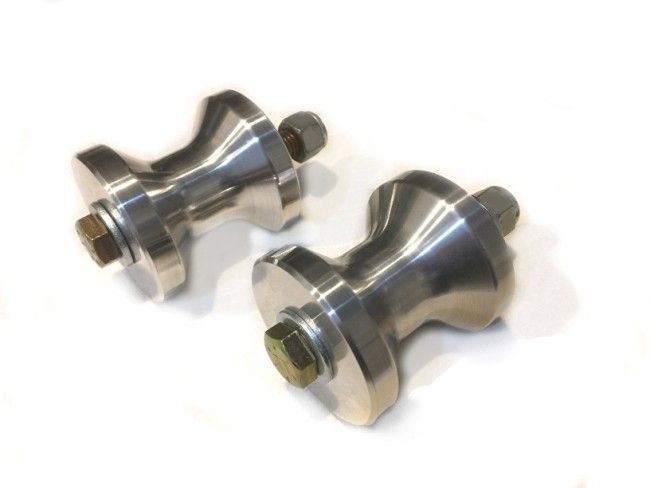

The LG Motorsports - true solid style

To me the cup design seems the best option as it still provides some vibration isolation, without play. The AFE mount seems like over time the thru-bolt bushing will fail. The true solid style seems like a bad idea for anything that sees street use - also making a solid trans bushing a requirement to avoid loading up the transmission.

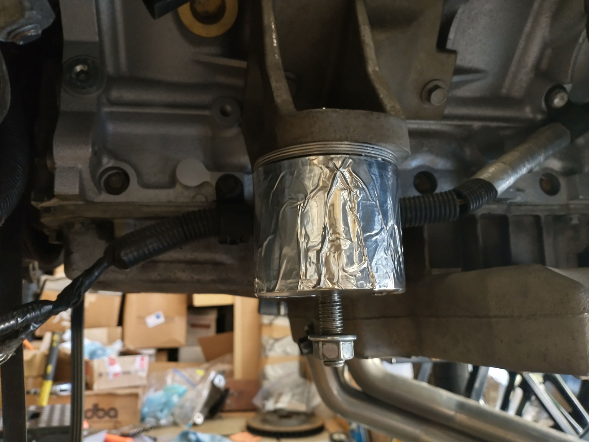

I have the Hinson #4051 units that are 3/8" shorter than stock. Then I used 0.531" ID x 3.0" OD x 1/16" thick SS fender washers from McMaster-Carr #91525A152 to get the exact position I wanted for my combination of parts with my engine and exhaust. I also wrapped the Hinson poly mounts in folded multi layered HD barbeque aluminum foil to protect them from the radiant heat coming off the ceramic coated LG Pro headers. I secured the foil with stainless steel ties (not shown in photos). The mount on the left is the old warn factory unit, one in the middle is new stock replacement mount, then the modified Hinson mount on the right.
