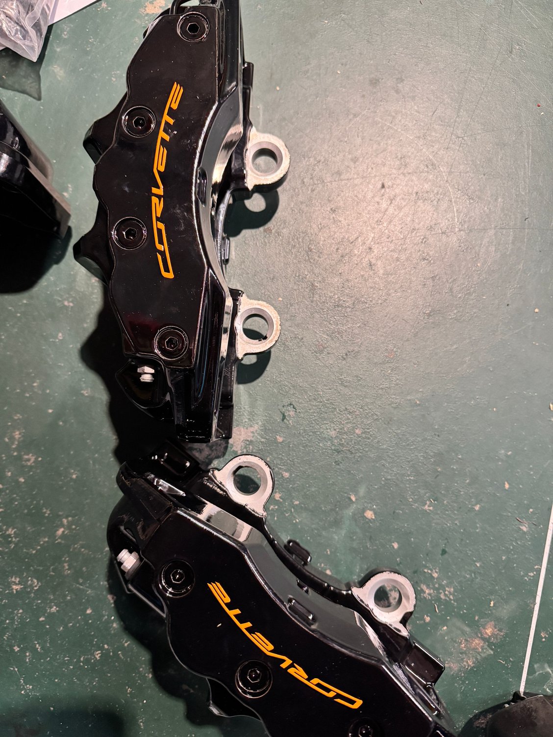

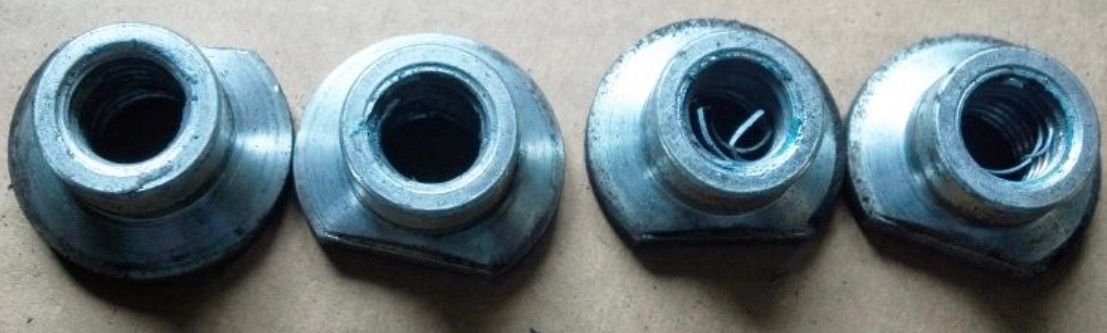

Hello, I’m new to this forum, I have a C5 corvette that’s I track and am looking to upgrade my brake calipers to the C6 Z06 calipers, I have a set of calipers however they are missing the threaded inserts that allow them to be bolted up to my C5. Does anyone know where I can purchase reproduction ones or have an alternative mounting solution. The picture below are my calipers and what the inserts look like for reference.

I’m wondering if you might get more responses in the C6 forum? As an interested bystander I’ve done a couple of searches and come up with no references to the threaded inserts — which does not happen often.
