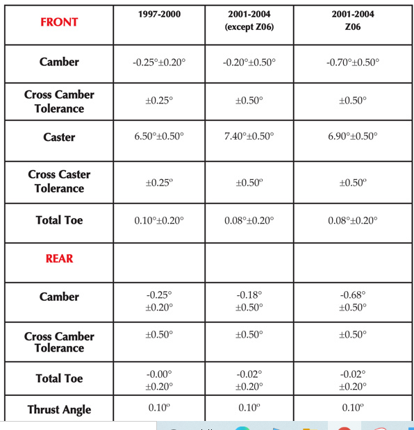

I would add to this that any good alignment includes first checking the tire pressures and ride heights. Also, before- and after-alignment printouts should be provided.
Request that the alignment settings be set at the preferred values [or as close as possible], not just within the allowable ranges.
